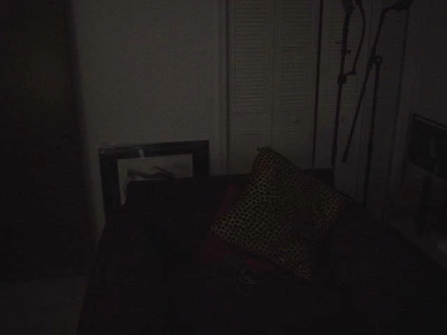

yes the first reflection points on the side walls and ceiling are covered. The back wall is not (there really isn't any good way to accomplish this). I could bring in some gobos to put behind me. that would only leave the desk which is definitely a possibility....but I have no idea how to cure that one!

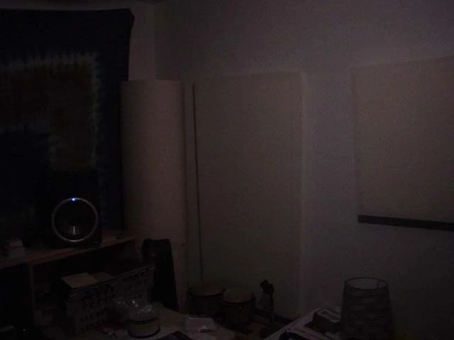

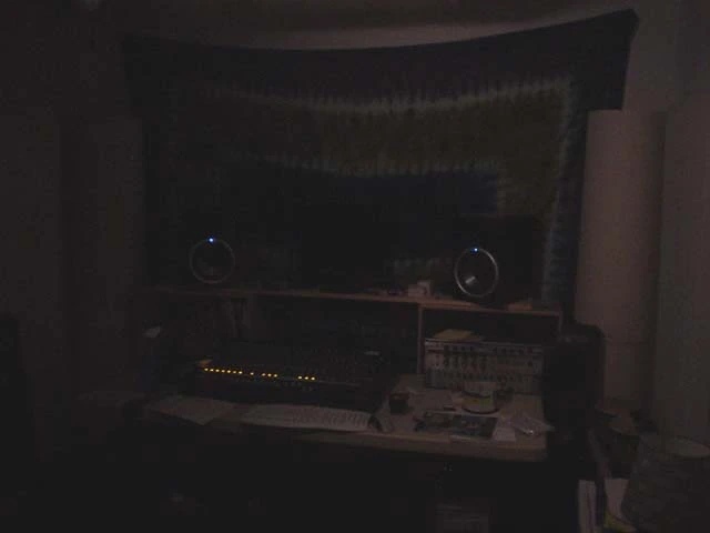

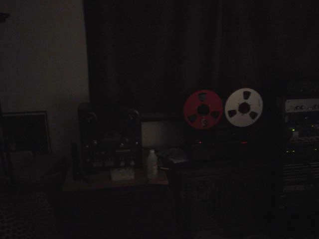

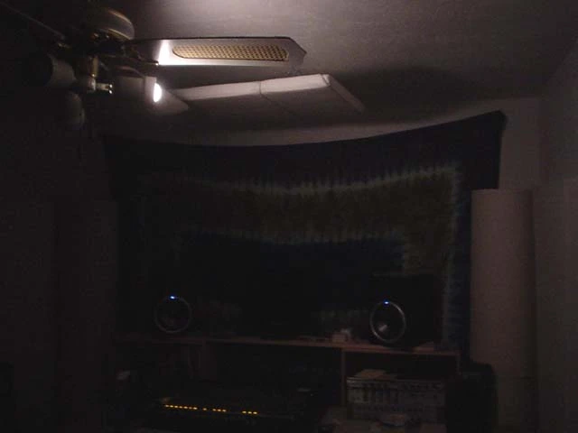

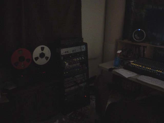

here you go...

Pay your electric bill so you can turn on some lights............. :D :D

anyway sorry about the poor images; I hope the size of the room was conveyed well at least.

Try to make a bigger cloud above your mix position. Also are you sure the "book shelf"(under the speakers) is not resonating?

ahhh, the left side has some reflective equipment and no panels, but the right side does have panels!!

the left side does have panels (see attachment). Its hard to make out but between the tube trap and the window covering there is another panel, directly at the FRP.

According to Ethan's diagram I should have the desk and speakers pulled back from the wall a bit. Unfortunately, If I did this my FRP on the left side would be a window...so I did the easy thing and pushed everything up against the wall.....I hope this isn't what is causing all of the problems...I don't really want to change that.

Ok, I see the panel now, but its lateral or even behind (toward the front wall) monitors. The tape machine and rack is almost exactly where the panel should be at-like on the right side. At least thatss what is appears to be. Also teh rack & tape machine is right about ear level?
