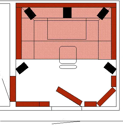

Don't think it's that much, but thats good to know. I'm going to be mixing in 5.1 surround, so obviously will need more acoustic treatment than the average person. Could you recommend where to put the broadband absorbers in my room. The room is a tiny 6'6" x 7'6".

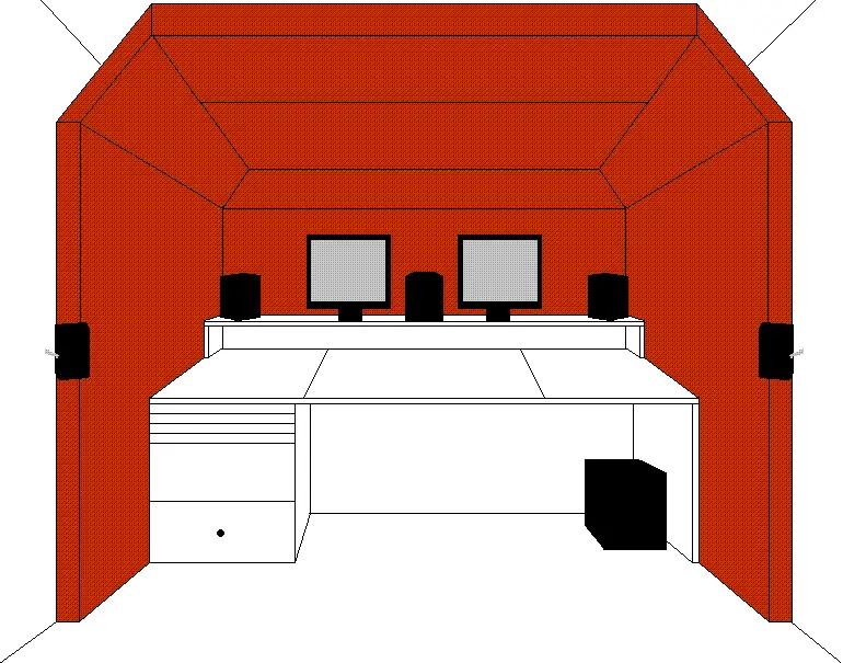

The old trick is to have some take a mirror and go around the walls and ceiling. Anyplace that you can see the monitors in the mirror, you put absorption. This creates a reflection free zone at your monitoring prosition.
Bass apsorption is different. You just need lots of it.

APL gave you the right answer. Then add as many bass traps in corners as you can possibly manage.

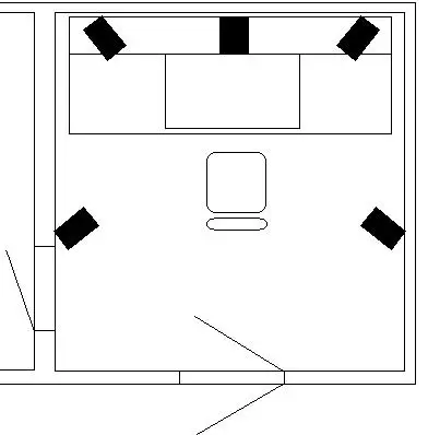

Honestly? I've been put under the impression that the lowest frequencies are what you wanna be trapping. Well the insulation i will using for absorbsion has a coefficient of .95 at 125Hz, so down at 80Hz it should absorb quite well. I'm not sure about wall-ceiling corners, 'cause my ceiling is very low. About 5'8" - 6'6"(I'm guessing) and I have doors and air vents to fit.I suppose i could have them at the mixing soition like the attached pics.
Nope. The absorption depends on the wavelength and that's proportional to 1/f. Those curves drop like a brick.

I'm not fully sure, but I think he is trying to tell you that just because your material is good at 125Hz doesn't mean its gonna be good at 80Hz unless it says its good there.

Probably way less than that.

I'm having trouble finding something to link to, but if you go to Ethan's acoustics page you can see how fast the absorption coeffecients drop off when you get beyond their useable range. And, frankly, I don't believe 4" of fiberglass is going to do much at 125Hz and I am suspricious of the specifications.
