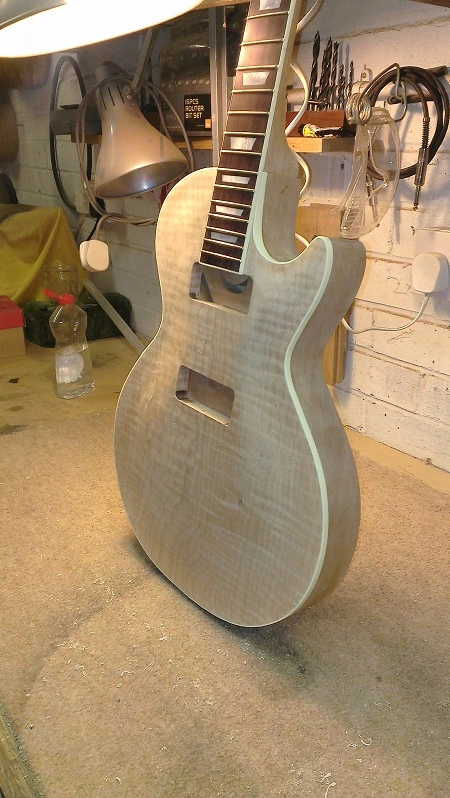

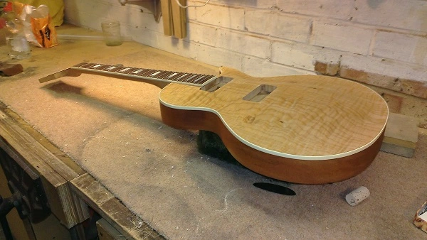

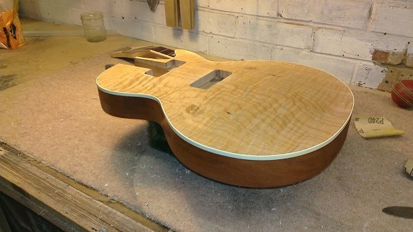

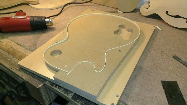

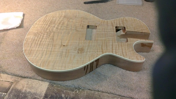

Anyway, binding is done.
Used a new supplier to test their binding and it looks great but was more of a pain to work than other stuff I've used..
I bent it with a hot gun and let it cool in a channel jig for an hour or so
After that it went on fine and cleaned up nice.
It's now ready for finishing and so the next few sessions will be all about scraping, sanding and getting it perfect before I hit it with a honey burst. I've gone down to 240 grit so far and now between grades I shall raise the grain each time to get rid of scuffs and make sure the surface is right. The stains will show even the slightest imperfection so I always spend twice as long as I think I should on this...

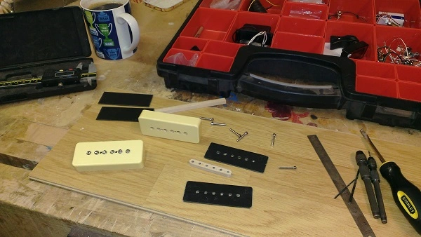

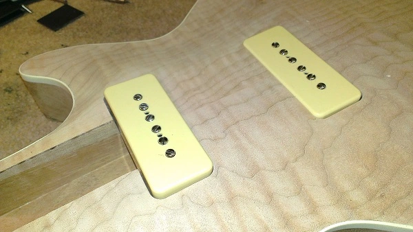

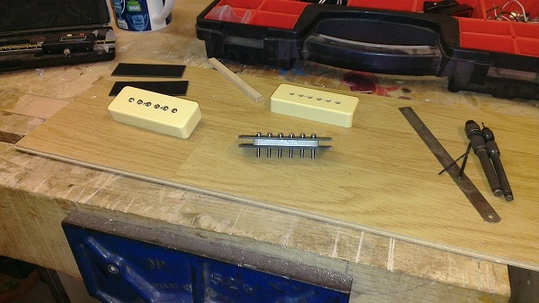

Had time to make the flat work for the pickups today.
I'm going to put a traditional p90 in the bridge and have made up a deeper bobbin to put my all new "Charlie Christian style" p90 in the neck...
The bobbins are old school made with Forbon and maple spacers. For those that are interested the traditional bridge pickup will have 42 awg wire and alnico 5 magnet and the neck will have as much 38 gauge awg that will go on the bobbin with a big fat secret ceramic magnet and a bronze bass plate.
A few pics.. Not very interesting but there you go. I hope to wind them tomorrow..

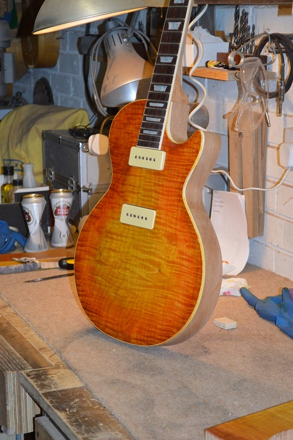

More interesting is the sunburst..
One of the advantages of building for myself and not a customer is that I can try out a few new things without worry in case things go tits up. With that in mind I'm trying out some new spirit stains on this. The ones I have been using are OK but these are supposed to be ultra colour fast... We shall see.
I'm aiming for a cross between a honey burst and a tobacco burst and will be rubbing it as per the old school Gibsons rather than spraying. I may finish with a bit of airbrush work if the rub doesn't give me what I'm after. I hate the sunbursts that just focus on the leading edge so this will work towards the centre without too much graduation.. hopefully...

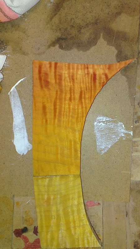

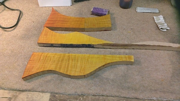

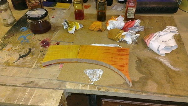

First thing is practice what you preach so I test on scrap.
Things seem Ok so I'm going for a mix of piece one and three.

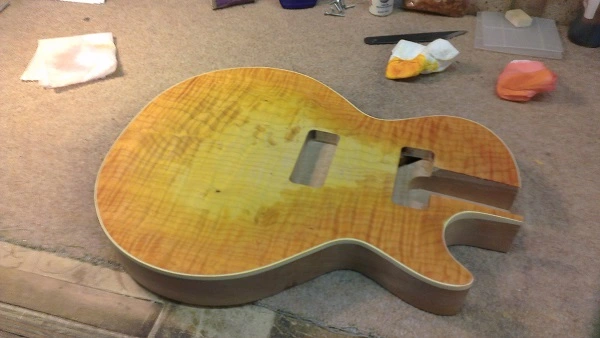

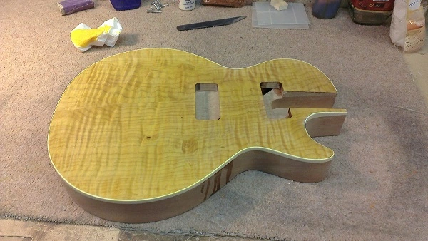

OK, here goes...
First wash the whole thing with spirit...

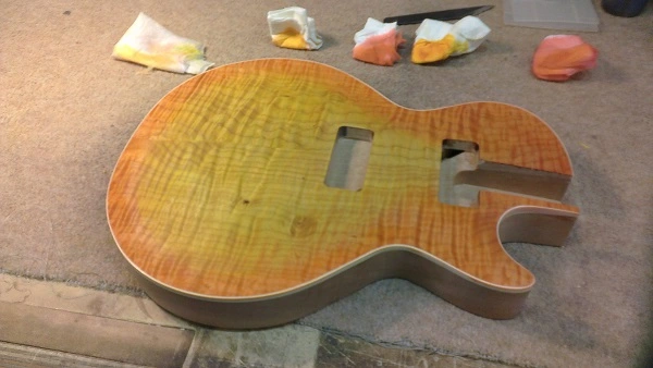

Hit it with a yellow all over

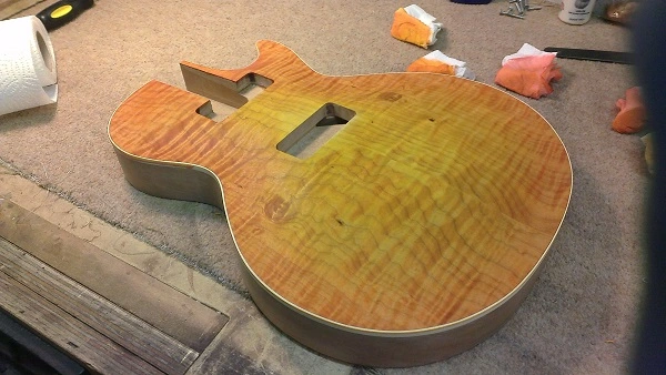

Rub in the Amber and red around the edge and work it in to the yellow keeping the spirit wet at all times.
Start to work in more amber and red.
Always rubbing with clean spirit and colour I'm tinkering to get a nice honey colour and finally add a touch of dark amber to the very edge and work it in.
The pictures don't really do it justice as the colours are a bit off and the transition is not as stark but I'm going to stop there and use shellac in the morning to drag it in a bit and finally hit a very fine tobacco edge as a final touch. All in all it's going to plan so far... The new spirit stains are good to work and I'll definitely use them again if the colours hold. More later..

Thats largely because sprayed sunbursts tend to come out that way when they are massed produced. It isn't that easy to do a good sunburst without changing spray cups five or six times. To do it right you need to shoot at least four colours with clear between. The best production bursts done with a gun that I have seen are PRS but I'm not a fan of their style. A hand rubbed burst always looks better and you really can tell the difference with a little examination.
