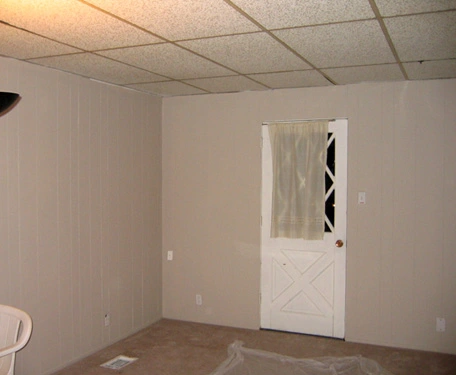

i took a couple of crappy pics of my studio space today, we just started painting it so it will look a little better, the old paint was in horrible condition. the wall surfaces are some kind of fiberboard sheets. ive included a picture of the back corner of the room. the door in the picture leads outside to a balcony which is on top of the garage.

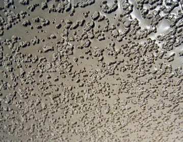

the cieling is kind of interesting....as you can see in the above picture, it's a bunch of long tiles which consist of a very thin plastic surface and are backed by about 1" of some type of fiber and is supported by a metal grid. above that is a thick layer of fluffy fiberglass insulation. are these tiles worth keeping, or should i plan on replacing them? i'm thinking if i get some type of laminate reflective floor surface in place, maybe i should just replace those cieling tiles with 1" (or 2"?) 703 wrapped in cloth and have the ceiling be completely absorbant. i'm still researching this, but in general is this a good or bad idea? the room as of right now is not very good acoustically. if i walk around the room while clapping, there are spots where it rings pretty wildly so i know some treatment has to be done. anyway i'll post more stuff in this thread as my studio progresses so you guys can see how i'm doing.
i've included a picture here of a detailed view of the surface of the cieling tiles. it's about a 1mm layer of flexible thin plastic, which i'm assuming is reflecting the waves as opposed to letting them get absorbed by the fiber backing.

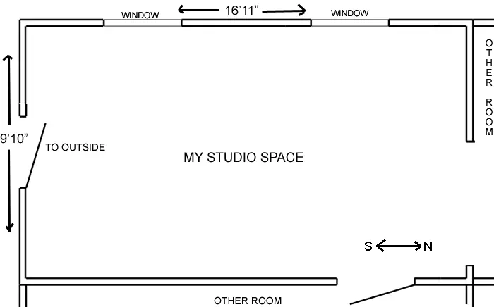

i threw together a quick sketch of how my room is shaped. i'm thinking of setting up my rack by the north-west corner, with my computer desk/monitors/lava lamp next to it on the north wall as close as i can get it to the "center". i'm thinking of putting in a sliding glass door to seal off the open space on the northern wall. for the drums, i'm thinking of putting them centered against the east wall. the guitar gear i'd put along the west wall. how does this arrangement sound to you experts? i normally track everything separately, but if i wanted to record a quick jam session, where would be a good place to put a vocal mic? oh and feel free to re-arrange my room as you see fit, haha. i still have to do some touch-up painting and stuff (possibly re-doing the floor) before i start moving my gear in there, so any suggestions as to the placement of my gear would be much appreciated.
here's the sketch i made, its made to very rough proportions haha... :o

That ceiling, by the way, is really creepy looking. In the first pic, it looks like a trypical suspended ceiling. But in the closeup, it looks like the Blob is trying to seep into your room through the suspended ceiling. If the photo is bad and that's not a terribly reflective surface, then go ahead and leave the tiles in place but put insulation above them. If that's a fairly reflective surface, though, you're going to have to replace it with something else before putting a laminate on the floor.
the cieling tiles are pretty reflective i'm sure. they aren't porous at all so i dont see any way for sound to go through them to be absorbed, the surface is plastic. the tiles already have a pretty thick layer of insulation above them, but i don't think it's helping any because of the reflectiveness (is that a word?) of the tile surface. after reading a bit deeper into the acoustics FAQ, i think i might go ahead and go with a laminate floor, and then use 703 as cieling tiles in a checkboard pattern with the current tiles, so that way i don't get overkill on the absorbtion on any one surface area. i still want the room to be as live as possible so i can retain somewhat of a "natural" sound on vocals and such. and about the foam on the traps, thanks for the suggestion Hapi, now that i think about it i think that makes more sense. the thing about treating this room is that as you can tell from the sketch, i'm going to have some problems with symmetry. i want to put a couple 703 traps along the eastern wall, but it would be difficult to arrange them in such a way that i can have traps in the same spot along the western wall as well. could this be a major concern? or is symmetry not a top priority in this case? thanks again, and i'll post more pics as the project keep rolling along.
If it were my room, I'd start by putting bass traps in all the corners. Thick ones, like 3 or 4 inches. Go floor to ceiling if you can. Then start treating your walls with broadband absorbers, which are usually 1 or 2" thick. You can use foam for this, too, but from what I've heard you'll get much more absorption per dollar with rigid fiberglass.
I think ptownkid's drawing is right on the money. The only thing I'd add is some broadband absorbers on the east and west wall at ear level (when seated) exactly half the distance between your ears to the monitors. I guess that means you'll have to put one on the windowsill.
I don't know how much 703 you've got right now or can afford, but if you need to do this in phases, I'd recommend saving the ceiling for last because you can always throw something cheap on the floor (like carpets and rugs) to tame floor-to-ceiling flutter echo while you save up for your laminate floor and your next batch of 703.
thanks guys. ptown, that looks like a pretty decent layout, but might be a bit of a squeeze with the drums set up in the room (this room will be for tracking and mixing). is it a must to keep the desk distanced from the wall like that? if so, i'd have to find a good use for the empty space behind the desk...are those traps on the east and west walls the "slat" type traps? wouldn't i need something more along the lines of broadband absorbtion? there's not much of a corner in the north-east wall intersection, but theres a spot above the doorway where i can hang a small trap where the two walls and ceiling meet.
