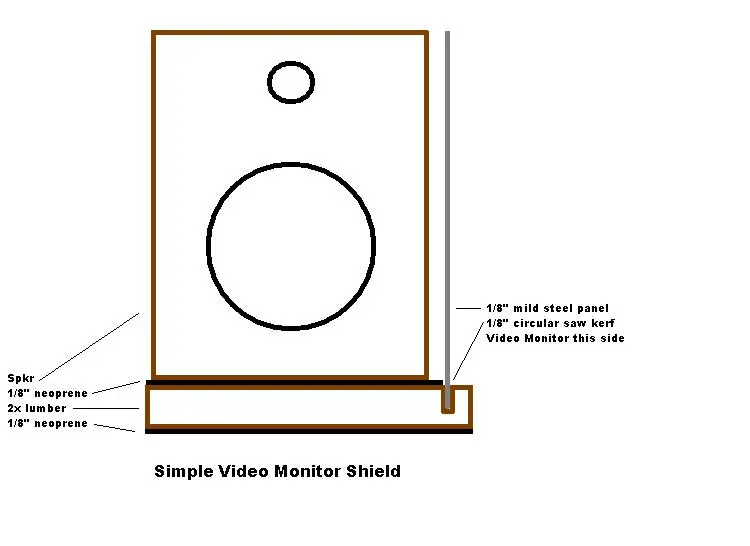

This is all you need to do; you can then place your unshielded speakers within an inch or two of the CRT's with no problems whatever - I've even placed a large "pickup" magnet right ON the steel plate and can still place the plate within 2" or less of a 21" crt.
HTH... Steve

Thanks knightfly i'll have to give that a shot and see how it works out!
You're welcome; you might even get by with thinner steel, not sure; I had some 1/8" plate left over from another project so that's what I experimented with. I actually was able to put the steel right up against the case of the 21" CRT and the speakers against the steel with no signs of discoloration or pix distortion.
Near as I can tell, it's not that the steel "shields" the magnetic fields, it's more like it "re-aligns" the field to keep it from causing interference with the CRT's deflection coils or phosphors... Steve
