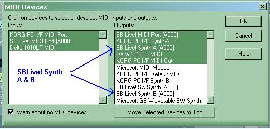

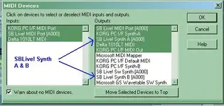

Well, first place to check is your Creative SB card. Certain SB card (like the old PCI my younger brother has) doesn't support soundfonts at all :eek: Thus you can't assign soundfonts from dropdown menu. Or there's some problem lies on the driver/OS which caused your current problem.
Here's some screen shoot if your SB card installed properly:
Notice that SB Live! MIDI port (or MPU-401) is phisical I/O port attached to your card. Soundfonts is recognized as SBLive! Synth A and B.

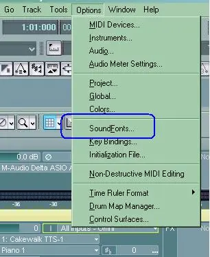

Then you'll find soundfonts available to open on Options menu...

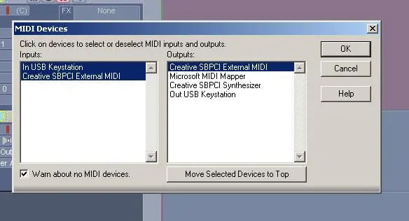

I only see the microsoft midi mapper. I've re-installed the soundcard multiple times and I've never seen anything like what you've got. Again my soundcard is a CreativeAudioPCI. Is this the PCI card you mentioned earlier? I have gotten this thing to work once before, but I'll be damned if I remember how. I even posted a song with the keys I did with the dreamstation. I found some bug fixes on the net for the SBLive! I'm gonna try those next...Thanx JAmes!!!!!And Toki!!!!!!

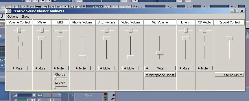

Ok I installed the new drivers and some things happened:
And also this new mixer with midi channel volume...

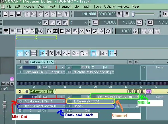

Having a closer look at your attached Track View, it seems like you didn't port your MIDI track to DXi track. You need to route your MIDI track to DXi track (in your case, Dreamstation track), and make sure you select Bank and Patch properly.
ps. I don't install Dreamstation, so here's my example using TTS-1 DXi.
Notice that first track is DXi track, and second track is MIDI track ported to first track. In your case, you need to select In USB Keystation as MIDI input, and select Dreamstation as your MIDI output. Then select channel 1 (for example), and select Bank + Patch. Done... Make sure you run audio engine (beside playback button), and play your keyboard...
