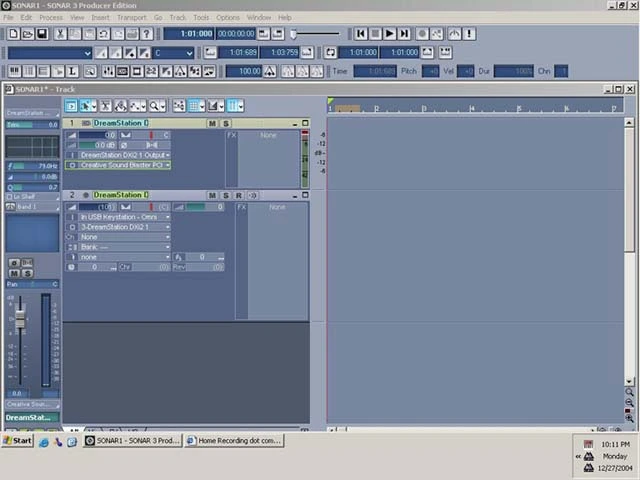

Hope you can see this ScreenShot

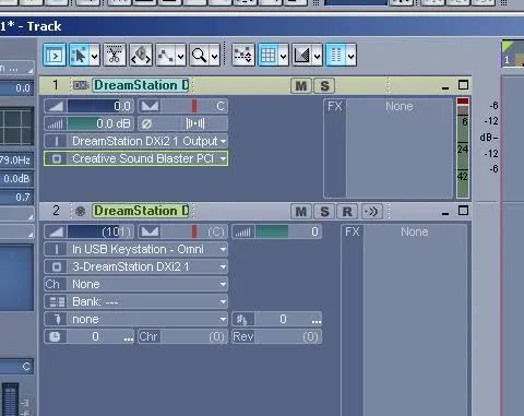

Is this right?

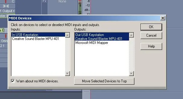

My devices are chosen as...

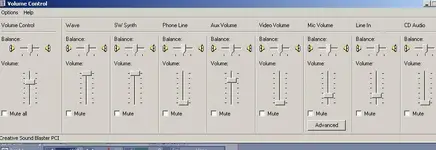

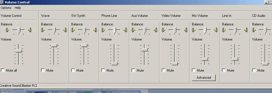

Here's my soundcard playback. It's a Creative AudioPCI. There are no updates for it.

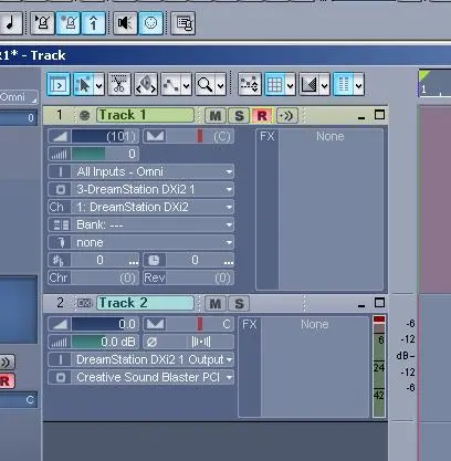

If its lighting up when you press a key the Sonar software is recognizing a midi command. Something appears to be amiss with the output mapping to the synth now. In the midi track set it up like the pic i`m attaching, In the dreamstation's track, in output, you have to direct it to the soundblaster for playback. and assign to "SB Live! Midi Synth" where it says maudio in mine.
It doesn`t show the "soundblaster MIDI synth" as an output device. Therein may lie the trouble. The UART is just a mapping gateway to send to other devices. The midi synth is a standalone synth even though its on the PCI card.
