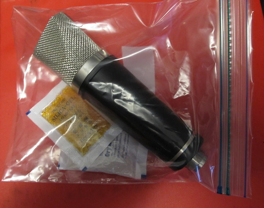

Are you in a part of the world that presently may have high humidity in the air? Mic capsules don't particularly like moisture on them which can cause a variety of problems. Moisture from your breath can also get onto the capsule.
You might try drying out the mic by putting it in a plastic ziplock bag with a couple of packets of desiccant such as the image below. I have a couple of mics that seem more prone to moisture than others and usually they come back if dried out a couple of days like this.

Oh, you *might* say it gets a bit damp around here, just a bit south of Seattle. <g>
I keep all of my mikes in plastic bags with desiccant packs. Absolutely necessary around here. And I never use the mike without a sock to (hopefully) block moisture and help a bit with plosives. The way I see it, it's excellent advice no matter where you might be.
Still, it's been a while since I regenerated my desiccant packs. Maybe I should try that and see if there's any improvement....
