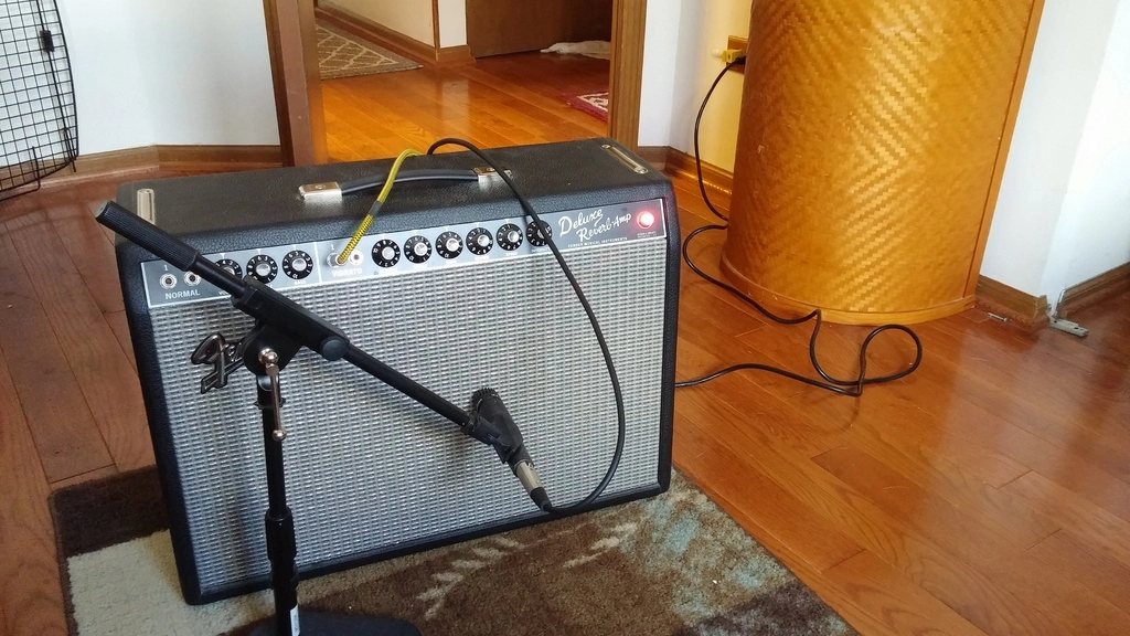

Here's what I've been doing:

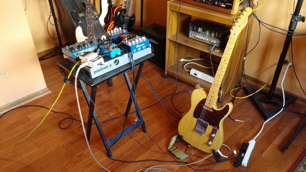

Guitar in the studio. A buffered tuner pedal in the chain reduces tone loss from a long cable run.

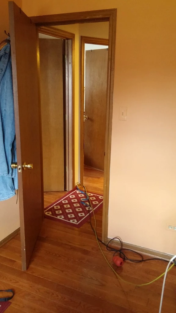

Guitar and mic cables go out into the hallway and then into the bedroom around the corner.
Amp in the bedroom, close-miced usually. I have a different setup when I use a ribbon mic.
There's about five minutes of hopping back and forth between rooms to dial in the tone controls and mic placement. Then I shut both doors and can monitor through my studio speakers at a comfortable volume. I don't really hear much of the amp coming through the doors or walls at all. Granted, I'm not recording a 100 watt Plexi through a 4x12.
