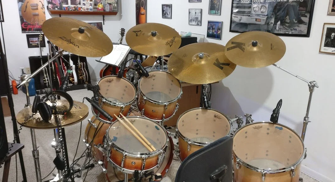

So I'm recording a Pearl Masters kit and I'm close-mic'ing all the drums. I've also recently started using Audix mics and the bleed from hi-hat bleed into the tom mics is horrible. So at this point, I have to EQ the bleed out of the tom tracks and not sure what the best type of EQ to apply here.
Any help is appreciated. Below is a pic of my kit and mic set up.
Thanks,
Dale

From the way you've miked the toms in your photo, I'd suggest you set your mics differently. Try turning them so they all face your right hand wall. I presume they are unidirectional mics so that may help cut out some of the hi~hat bleed. The way the hi~hat is played also has a great bearing on their bleed to other mics. I've found when recording drummers that some really whack the hats but the strange thing is that they don't need it. Even fairly light~ish playing will still be picked up loud and clear.
What sort of music do you record ?
Agreed, Grim.
The mic on the left most tom is pointing straight at the high hat. Rotating in 90 degrees around the drum head should put the HH out of the polar pattern of the mic.
Of course, there is the old 60s-70s trick of removing the bottom head from the tom and micing from the bottom. I was watching a broadcast of California Jam, and it looked like a lot of time there was a 421 stuck up under the toms.

While moving the mic around to put the hihats in the null is probably a good idea, I bet it has more to do with the playing, hitting the hihats a lot harder than the toms. But at least try moving the mic.
Maybe part of it is also the hi-hat cymbals...if they are loud/cutting and more intended for live use...?
I use Zildjian A Mastersound 13" hats...and I also have another 13" Mastersound pair that has a K Mastersound on top and an A on the bottom.
They both have a very smooth, hit and chick sound...with the all-A hats being a tad more brighter and the one with the K a tad darker...but neither is loud or cutting.
AFA using EQ...it's going to be something in the 2kHZ - 5kHz range, I would guess...really depends on the cymbals...for you to remove the meat of the hats from the toms...but, you may very well also kill the attack on the toms when you use the EQ.
You also seem to be in a pretty tight space there from looking at the picture...and I don't see much in the way of acoustic treatment.
If you deaden the walls/ceiling a bit, it will help suck up the highs coming off the cymbals...but that's a whole other topic. :)

So i am going to suggest something different: Put something on the walls to reduce the HF splashing back and turn the kit around 180 degrees.

It's usually the last thing a tech suggests and the first thing a drummer suggests; play the hat quieter.
If the drummer really is in control and that piece of the kit is simply too loud for the set, switch it out.
If the drummer is on point and the kit sounds perfectly balanced in the room then the mic position is possibly a problem.
Place the hat in the tom mic nulls (by moving microphones).
If all of that is under control and bleed is still a problem, consider the possibility that it's not.
Bleed is meant to be there and, like hiss, it's very easy to notice it and then become so focussed on it that you lose perspective.
