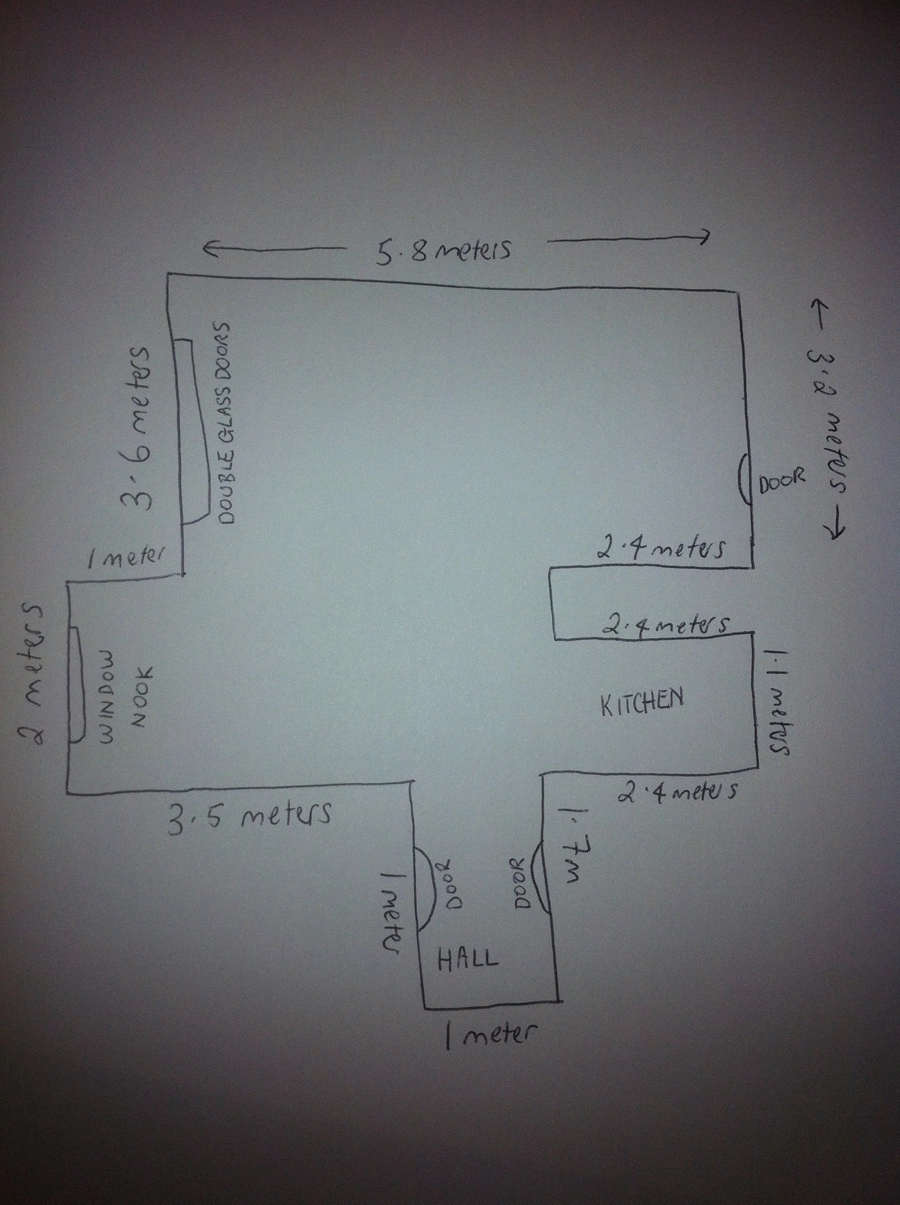

The other thing about the lounge I am unsure of is the shape is a little wierd. I've attached a drawing to this post of the shape and dimensions so you can see what I mean. Both rooms are of course full of furniture too, they're not empty. I'm open to better suggestions in the lounge room if it's going to be a better option, but hanging blankets all over the lounge room I don't think is really an option.

Ooo! Not a lot of room is there? But are you sure all your measurements are correct? For instance, is that kitchen really only 43 inches wide?

LOL, My Bad. I can tell the difference between the words "hall" and "kitchen"
