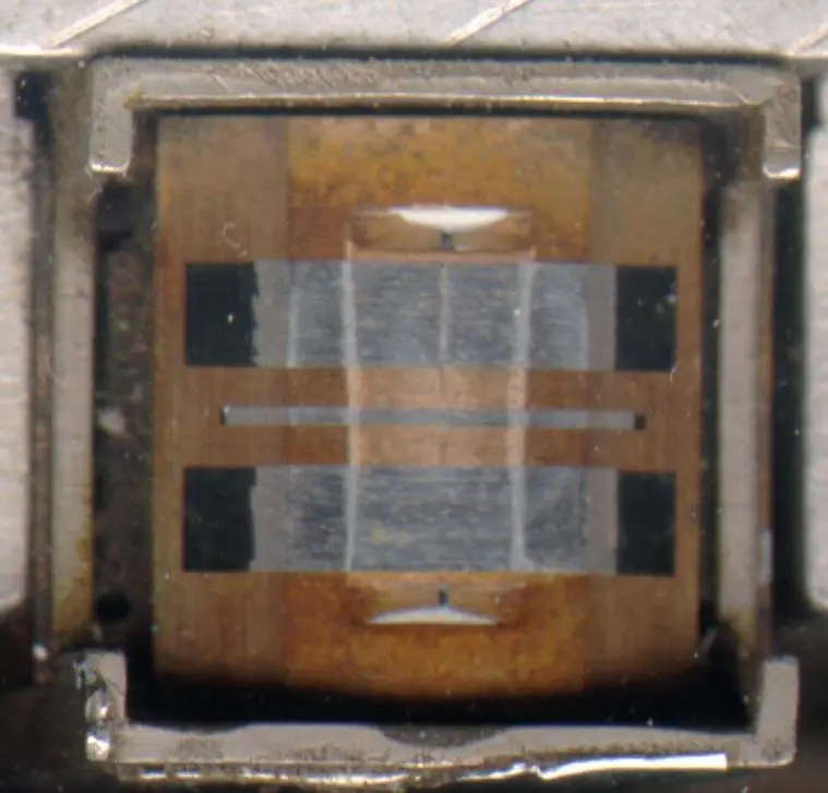

They would scare ME little. Head re lapping is not cheap.
I could be wrong about them. Some heads are flat and some are round. I think head relapping is about $100 a head. I think that's about what I paid. On some decks the guides can be turned. It's the other stuff I wonder about. How do you test it out with out a pinch roller?
its in the heads
Those heads are very worn. very much like the lifters. I did not see a blown out gap but who knows how much head life is remaining. Here is a photo of a blown MCI playback head. Notice how the upper track shows a very distinct line and the lower does not. In looking at your heads (you are showing the record I think) look for a very fine line for the gap. If it is easy to see in places or all the way across then it is a bad head.
You can put sleeves on the lifters and rotate the guides. But a blown head needs to be replaced.
As far as re-lapping, You might want to try that yourself rather than spend any money on these heads. I'm guessing that these heads are down to 25% or less left. This is based on the width of the worn section vs the width of the side grooves. Notice on my head that the flat is the same as the side groove.

Something else to note; as repro heads wear, the high frequency response is natural and normal to keep increasing, up until the point that the gap is completely gone, at which point you just end up with unbelievably horrible distortion. Record heads work in the opposite way, in that as they wear down, their high frequency response keeps dropping.
As one can see from that co-relationship, the frequency response of the same deck can remain fairly constant as the heads wear down evenly together but, the noise characteristics will slowly drift to the ugly side as the electronics limits get pushed further and further away from their tolerances with each progressive calibration to keep everything aligned.
Re-lapping is definitely cool and usable but nothing beats new heads and quiet supporting electronics.

I'm going to take a wag (wild ass guess) and say that based on these better photos of the heads that after a re-lap you will have between 30 and 40% left.
They are flat but would still work as is.
