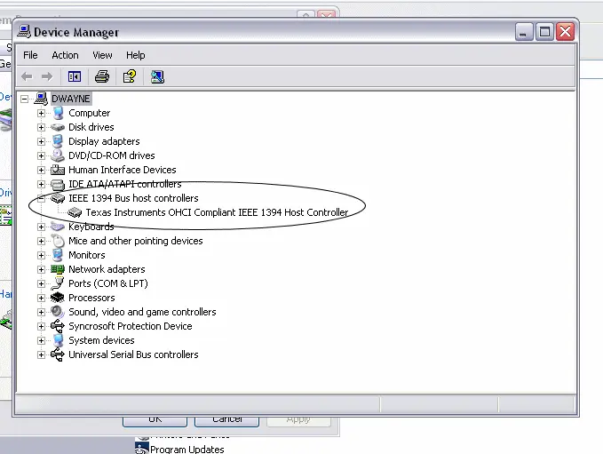

IEEE 1394 does not mean TI. It just means firewire. You'll probably have to contact hp tech support to find out if it's TI chipset. And even then, they probably won't be able to tell you.
When you go to Device Manager you should see something like this.
Thanks. Interesting - turns out my current is a VIA. And they are approved by Presonus. Mine works very well. I will try and find out what chipset this laptop is because I really like everything about it.
