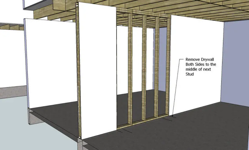

Oh, and btw, I had already finished 6 shots of a tutorial on how to do what you asked, when it dawned on me what I wrote. So, down the road, when you REALLY need help, don't be afraid to ask. :)
Here's one of the jpg's
