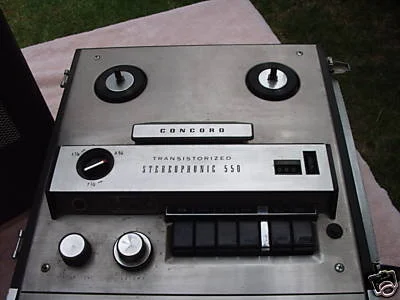

Does it look kinda like this?

Haha, yes I suppose I should have tried to fix what I already knew was wrong before looking for help!
As for the picture, that almost exactly it, the only difference I can see from this picture is that my Volume and tone knobs are a slightly different, they're in the same location just a different knob and I can't see if the VU meters are the same by the transport section, but again they're in the same spot. Its got those speakers which are at the left edge of that photo. But yeah I'll post up some pictures of the inside and out ASAP.
