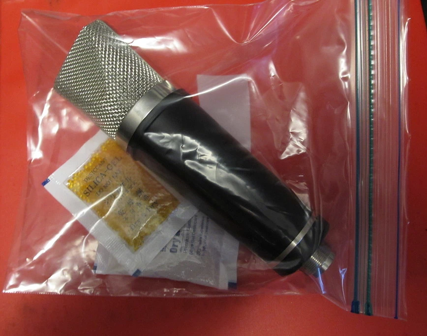

Do you live where there is much humidity/dampness? Sometimes even where it is stored can be damp, but not obvious. A loss of signal from the mic might be moisture on the microphones capsule which can 'short out' the bias voltage on it and reduce the output and sometimes make noise. You could try placing the mic in a warm dry location for a day or two and see if it comes back. What I do when I have mic that's absorbed moisture is place it in a plastic ziplock bag with some desiccant packs which pulls any moisture out of the capsule as shown below. I have two mics that seem to attract moisture, so they usually get stored in a bag with desiccant packs.
I live in istanbul which haves low humidity I guess and I will try the method that you recommended
