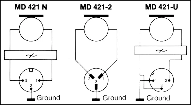

Yes, I've soldered the cable like this. I understand that this is the rear view?
The pins should be numbered, but the numbers may be very small. I was trying to work out what would happen you got it wrong, you could end up with an unbalanced mic with a loss of some dB due to the shield and on of the pins being bridged through the mic?
Alan.

Unfortunately, Sennheiser applied rather peculiar standards and these numbers will not match XLR:
Nevertheless, I think I got it right as the shield pin will always be the middle one (in Kleintuchel connector). It is possible that I've wired incorrectly pins (-) and (+), however I assume that this should result in nothing more than reversed polarity. At the moment I think that Focusrite 2i2 simply provides too little gain.
