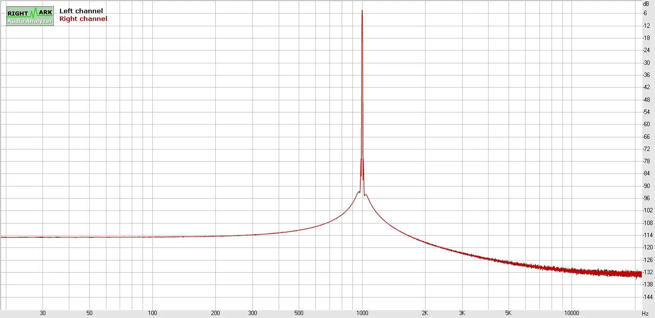

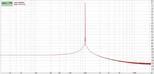

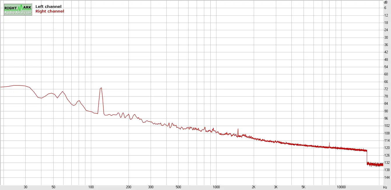

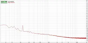

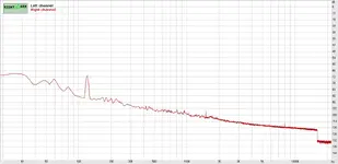

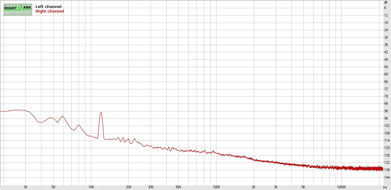

You can see that in my setup the analyser under reads -1dBFS by about 5 dB? This would put the 120Hz peak at about -80dBFS for the lower level clip. BUT! I cannot be sure because I don't know where -18dBFS is (for e.g.) on your recording when processed thru Right Mark Anny.
However, if we add an A weighting to the clip (anyone know of any weighting software BTW?) that would push the hum down about another 15dB but such a visible 120Hz spike worries me, I suspect poor filtering or/and regulation on the HT or/and heater supplies?

"How do I give you the calibrating blip?" Just make a noise, "Mary had...." at about -20dBFS (tell me where) then leave the controls alone and let it run for few more seconds.
But, as Jimmy says, those noise figure now seem easily good enough. If you have one, a bit of acoustic guitar at a foot (300mm) would be a pretty stringent test. If the hum is not audible at sensible and original sound levels, you have cracked it!
I really hate to see hum in a system! I think it should be a thing of the past now that chip regulators are so cheap and that 120Hz is 24dB above the surrounding noise floor (there is an approx' 6dB per octave rise in the noise floor ref 1kHz. Not sure what that is but I often see it in peoples clips.)
