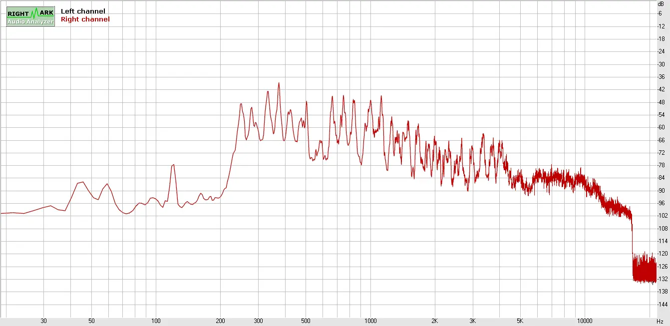

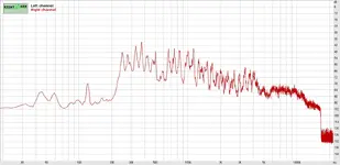

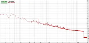

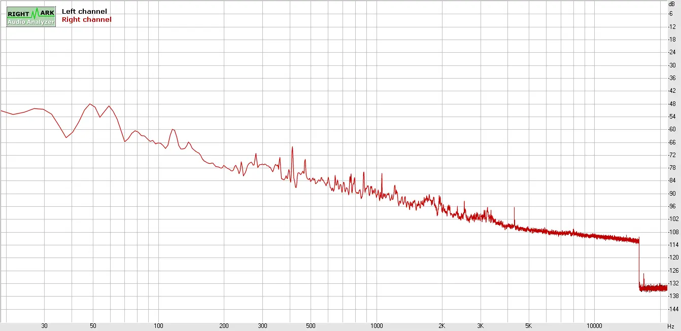

Thanks for the graphs, ecc.
What does it mean that the foil reduced the hum? What can we conclude from that? Again, I'm an idiot when it comes to the actual engineering side of this.

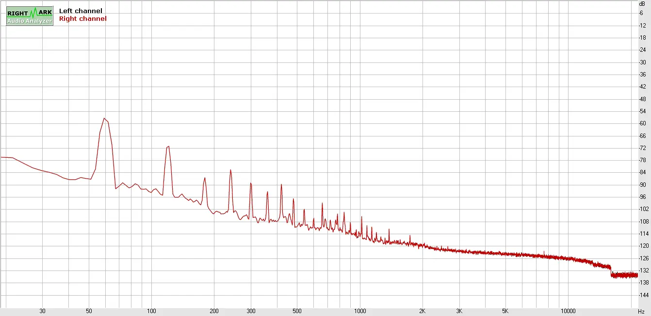

Well things are certainly s lot better but as the spectrum of the last but one voice shows (about 20secs of it) the 120Hz hum is still only some 36dB below the average modulation, not very good in my book! I don't like to see hum at all!
Changing to an earthed mains cable seems to have improved matters a lot but the need for the foil is worrying? As Mixit says, in his own elegant way, be good to check various "bits" for continuity!

Note on sound clips if I may? To get then into the analyser it is much easier for me to have an MP3 attachment (.wav would be better but not allowed) ten seconds at the best bit rate (but mono is fine). Stuff sent on Clouds etc I have to first record and then edit and export. Plus, a "whooo" at neg 20ish and then silence is best.
