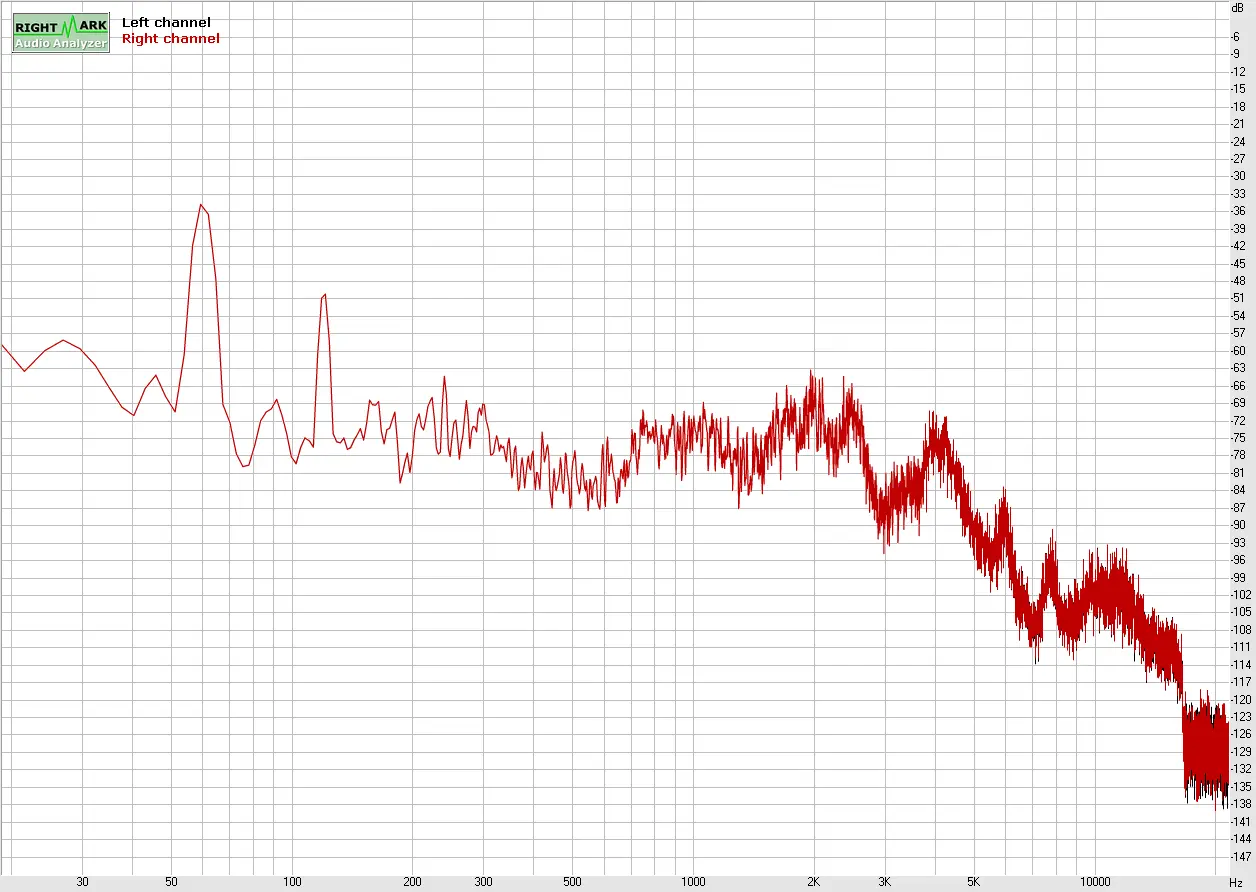

Lethal voltages in all. The spectrum attached* shows a massive, fundamental hum at precisely 60Hz and a decent bit of 2nd harmonic at 120Hz. The former has to be caused by a missing earth/ground connection or (and I had an ignoble mate, sorry!) a ground loop between the mic PSU and some other mains powered, earthed device, computer, active monitors or other.
If the hum was just 120Hz it could be bad filtering in the PSU but that would not throw up 60Hz.
I have never read or heard of a valve cap' mic supply causing a hum loop and I would have thought any maker worth his salt would know of the possibility and design it accordingly?
*Had a bit of a job isolating a section with the hum (kept saying to self "that's nice girl but FCS shut up for ten seconds!") Peeps, if sending in samples for noise diagnosis, ten secs of waffle for level then twenty where you STFU please?
Bottom line: Faulty mic IMHO.

Not the 7 pin cable - try lifting ground between the PSU and the preamp/mic input. There are some hefty HT voltages inside the PSU, which hurt - lots!
As an aside - the UK version sounds quite different - the difference between 50 and 60 Hz is pretty pronounced.
Just a +1 for what ecc83 said. Unless you know exactly what you're doing and have lots of electronics experience, don't mess with the mic, cable or PSU. The voltages floating around in there are potentially lethal.

Does the UK model hum as well then Rob??? Heh! And yes, 60Hz is an unfortunate mains frequency! Many small monitors are "tuned" about there but LF output falls sharply below it.
Cheers Bobbs. I have never looked at any valve mic PSU schematics but I would have though a floating, balanced output would have been pretty vital with a CR anti-loop network in the screen?
ecc83, you are the man. thanks for doing that.
I'm not technical enough to know exactly what it means, but i get the general idea.
Ha! trouble is that 60Hz is more of a real note, and the first harmonic helps turn it into something more than what happens here - where it's more an annoying hum, and not a proper 'tone'. seriously, though, there's a big capacitor on the rectified HT side, and back in the 'good old days', when these failed, the nasty ripple on the anode made a quite distinctive hum - I've never heard the 60Hz version, but in a new mic, it's a send it back job, once you rule out the ground loop.
