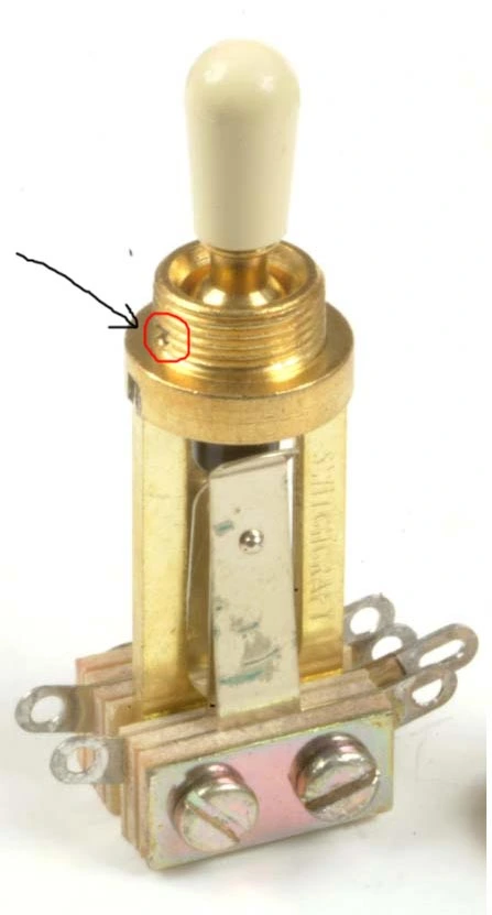

tonight it fucked up again. the only thing i can see wrong is what i think is like the "axle" that the shaft is on. on one side, it sticks out a bit, but on the other side its pushed back in. i dont know if its supposed to be so far out on the one side or if its supposed to be even on both or what. it looks like it may be a very small allen or hex screw. how can i fix this so its nice and tight and doesnt wiggle or stick off to the side?

this is the part i'm talking about. on one side it sticks out a tiny bit and on the other side its pushed in pretty far.

That's just the axle that the ball part of the switch pivots on, it's not an adjustment.
When the ball gets worn to the point where there is slop around the axle and/or slop around the ball itself, the switch will do as you describe. Time to replace the switch.
