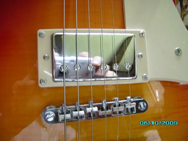

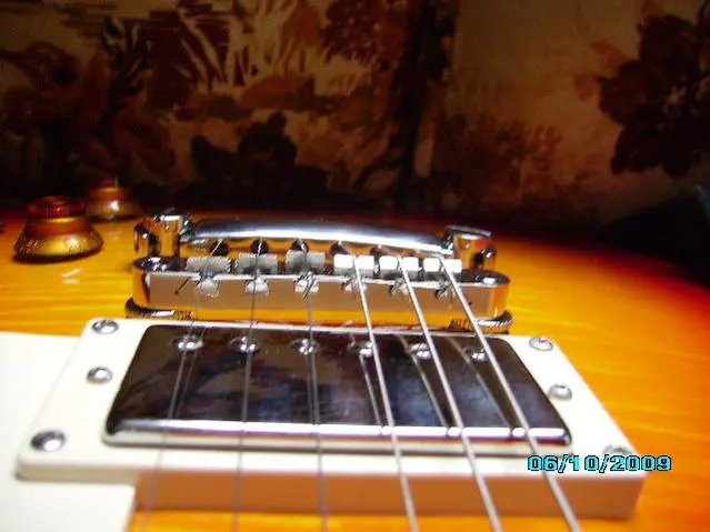

Hi everyone. I've got a problem I hope someone can help me with. I bought a new Epipone Les Paul Standard Plus Top. The problem is the little E string has kinda of higher pitch or twangy sort of sound. I adjusted the bridge so the strings are at the 4/64" for the top strings and 6/64" for the bottom strings ( standard settings according to the manual ). Do I need to adjust the pickup's or raise or lower the E string at the bridge using the little screw for adjusting each individual string ? Of all the years I have played and this has never happened to me before. :rolleyes:

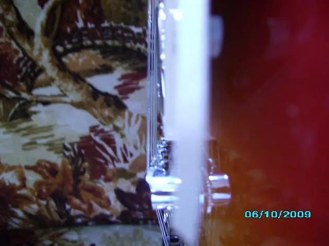

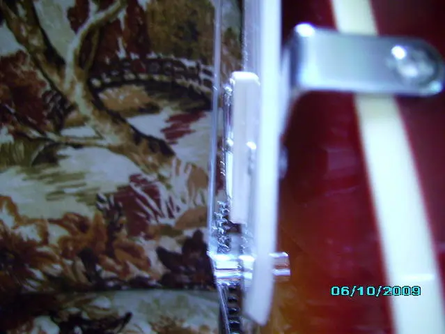

It is hard to tell from pictures, but the bridge pickup looks very high to me - are you depressing the strings in those pics? If not, it looks to me like when you fret that the strings might actually touch the polepiece screw, or possibly the pickup cover. Depress the strings and see if the string(s) touch anything... they shouldn't.
If they do touch the pickup:
I would adjust the pickups down. Its not some critical adjustment that needs a pro to calibrate it or something, it is not permanent, and won't damage anything. The way you would usually "calibrate" pickup height is to measure the distance between the string and the polepiece screw with the strings depressed at the highest fret. For that guitar, and the relative magnet strength of the pickups in that ax, I personally would use either a popsicle stick or a nickel as a thickness/feeler gauge for the highest it should be. Depress the strings at the 22nd fret and then adjust the pickup height screw(s) until the string's distance from the polepiece screw is the thickness of the stick under the high E. Now adjust the low E side to where it is just a bit lower - like 1.25 or 1.5 x the stick's thickness. That ain't real scientific, and doesn't include adjusting the individual polepiece heights (to compensate for the neck's radius, and consequent difference in string to polepiece distance), but it will get you into the ballpark. Later on you can read up on pickup adjustment and fine tune it.

It is hard to tell from pictures, but the bridge pickup looks very high to me - are you depressing the strings in those pics? If not, it looks to me like when you fret that the strings might actually touch the polepiece screw, or possibly the pickup cover. Depress the strings and see if the string(s) touch anything... they shouldn't..
No, I wasn't depressing any strings in the pics. I have checked everything but not adjusted anything until I know what to touch.
