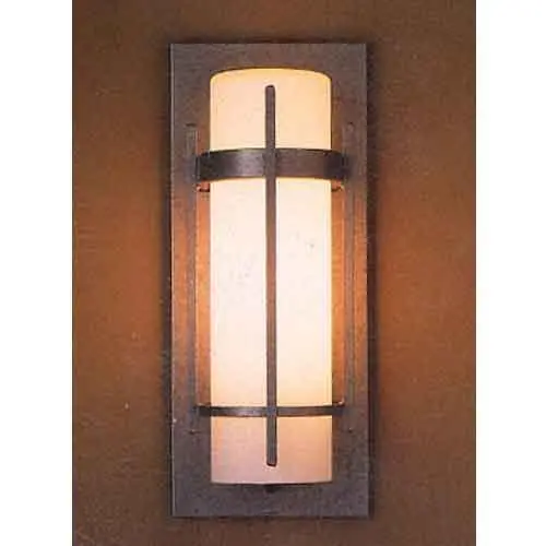

Here's the wall sconces I was thinking of:

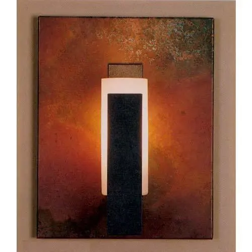

And here's the outdoor sconces:
They're different, but share enough similar design elements to work together.
If I could just find some tracks with that sort of look or feel... I think it'd be cool. :cool:
