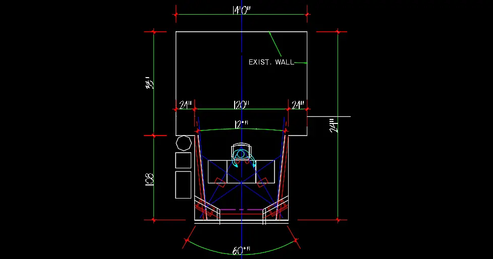

Well, I'm moving along slowly but surely on a basement studio project. I'll attach the layout also (kindly done before by R. Fitzpatrick).
As with most projects you wake up one day and say "What the hell!? I just forgot something!" So, today I realized that the 5-inch lighting cans I've planned for the ceiling might not work with the floating cloud(s) that will hang below them. Duh!!!
In the rehearsal/recording end of my studio plan I was going to place 4 resessed light cans. Now I'm wondering if I should leave these out.
Question 1: Would a good solution be to go ahead with the 4 lights, but plan on putting separate floating clouds up near the ceiling but between the lights? That is, within 4 inches of the ceiling?
I also will have a separate cloud over the mixing position.
Quesiton 2: Am I correct in concluding that a cloud over the mixing area should be spaced lower from the ceiling than those in the back end? Perhaps a foot lower?
Ceilings are all 9 foot, by the way. Or 8' 10" precisely.

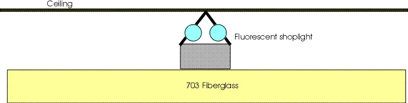

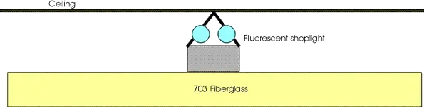

One trick you might find fun would be to incorporate indirect lighting into the clouds themselves. In other words have a two foot bare tube fluorescent hung with the tube up and then hang the cloud from it...the light would be coming out from all sides of the cloud.

Thanks for the ideas, Innov.; your name is very appropriate! :) Those are great points. I didn't think about the glare and rattle. I wonder about the heat issue, though, of hanging the 703 off the light fixture.
