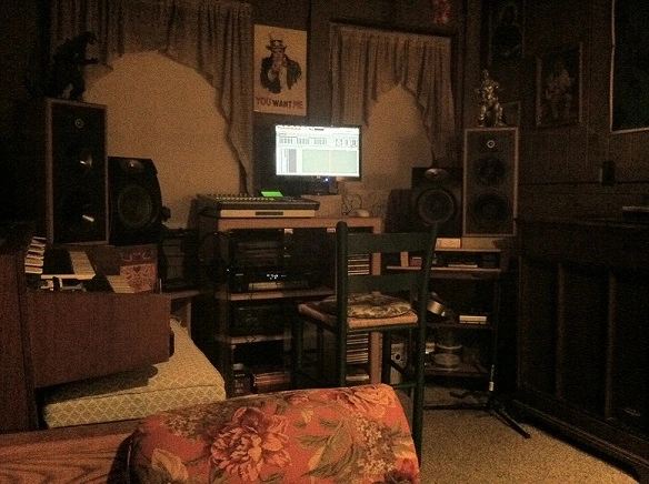

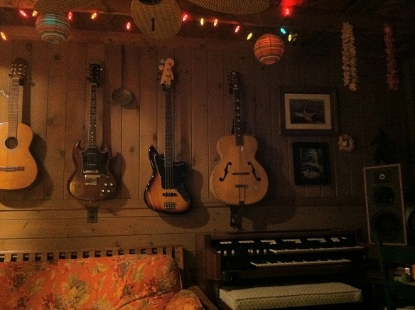

Hey - I recently got a new bass and and old hammond M102 organ with a separate tone cabinet. Trying to squeeze everything into such a long, narrow room (19'L x 9.5'W x 8.5'H) where most of the length is already taken up by storage, a wood stove, a massive bookshelf and a futon, is kind of tough. I like how I have it now though. I bought wall hangers and got the guitars off the floor at least.
Sorry the pics are so grainy. I was fooled into thinking they were clear when viewed on my phone.
I had to work hard to cram everything in there. I don't have room to move the mixing set up away from the back wall, and the room is so narrow that the backs of my big speakers are pointing right at the corners. That's probably going to mess with the bass response, but I thought I'd heard it was better to face the short wall in a rectangular room?

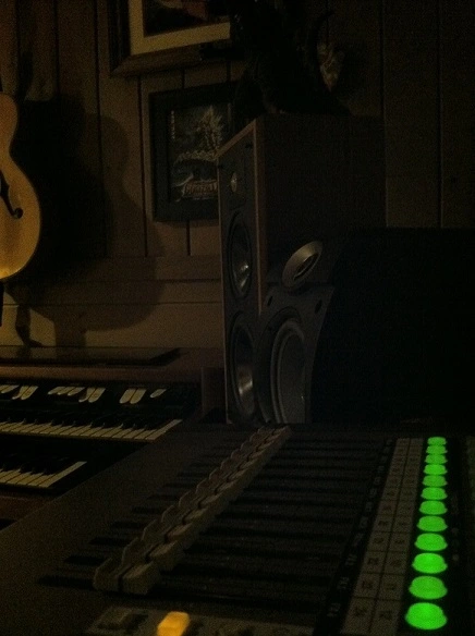

I'm never going to be able to fit a drum kit in here if I ever get another one!

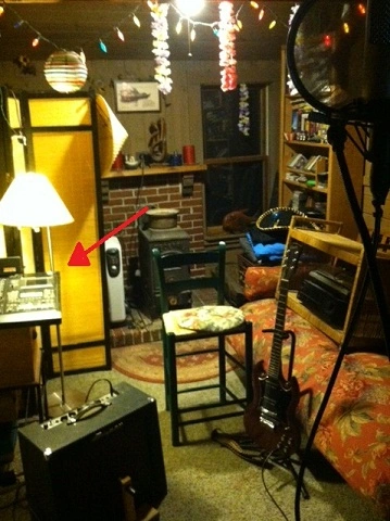

And finally...some lights.

Yeah, you've got the mixing area pointing the right way, just need to trap those corners. Wood stove and all those guitars hanging out? Hope you've got some serious humidification devices going.
Not sure there's enough room behind the speakers for traps of the thickness and width that everyone talks about.
I do have a large dish on top of the stove that I keep filled with water whenever it's running (which is only some of the really cold weekends during the winter). It evaporates into the room. Not sure if it helps. I never had issues when they were on stands.
Here is the thing tho, once you hear what they do for the sound in your space, you will make room. :)
:) We'll see. I remain unconvinced. I'll have to see how it goes over a few tracking/mixing sessions 1st and go from there I think.

It's not really a matter of opinion. It's fact. You can't argue with physics. Having said that, you make good recordings with what you have. :cool:
Thanks for saying that, but yeah, I'm not arguing with physics :).
I trust that the laws of physics dictate that the sound in my room would change in ways that might be somewhat predictable if traps were added in those corners, but that doesn't mean that it would necessarily be worthwhile. There are too many other factors, and ultimately, it is almost entirely subjective.

You can't accurately know what those other factors might be unless your room is telling your ears the truth. Right now, your room is lying to you. But we can go back and forth forever nit-picking semantics, and I'm sure we both don't want to do that. Anyway, the way I look at it this way. Treating your room can never hurt. It will either help or make no difference, but how can it hurt.
I would go out of my way to say that it will absolutely make a bigger difference than any other upgrade. My control room is 27 X 13'. Room treatment made a gigantic difference for me in regards to mixing and vocal tracking. Things were just super easy after treating the room.
Everyone who hasn't treated a room realizes what is improved after doing it. Always the same reaction; 'Holy shit, why didn't I do this sooner'. If you wish to avoid physics, then see ya when you come around to reality. :)

I trust that it made as big a difference for you as you say, and that's great. It can't apply equally to everyone in every room/situation though, right? That seems like over generalizing. I've heard plenty of shit mixes from well treated rooms and some great ones from untreated ones.
Personally, in the absence of an absolutely piss poor room (mine doesn't sound that bad really), I would invest in instruments, amps and microphones first. Maybe that's just because I don't have a huge amount of those things yet.
I do, and I can assure you life is no less real as a result :p :).
I am not trying to push anything on you man. Yes, great things can come out of a untreated room. Not even going to argue. You will know when you actually perform the desired treatments for your room. I am just giving my opinion based on fact of how acoustics work.
No need to fix what ain't broke. But what if it wasn't a fix, and you suddenly realize there was something broken? Won't know til you try. Or care.

On your space....looks cozy, but Jimmy and RAMI are right, you should at least toss a couple of traps in there where you can, and see how it goes. You can also hang some from the ceiling if you don't have enough wall space....just consider the best places to put them.
I totally understand that it's hard to cram 20 traps into a room where most of the space is already taken up by instruments and recording gear....and of course, they come first....but some trapping will tighten up your low end and/or help with general broadband control.
