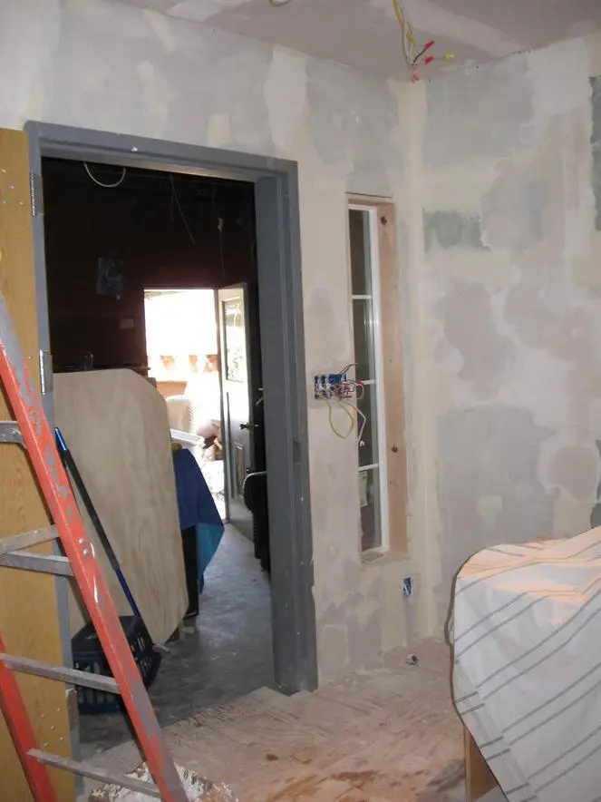

painted.
Done painting, now to start on the floor.

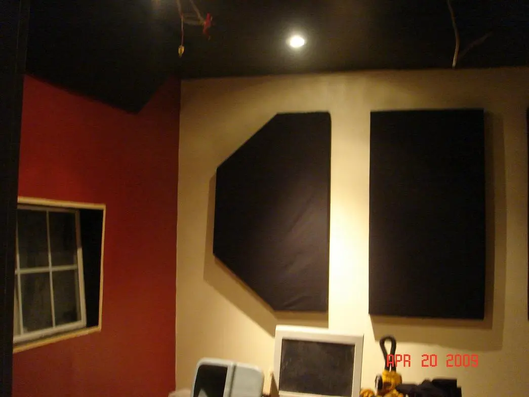

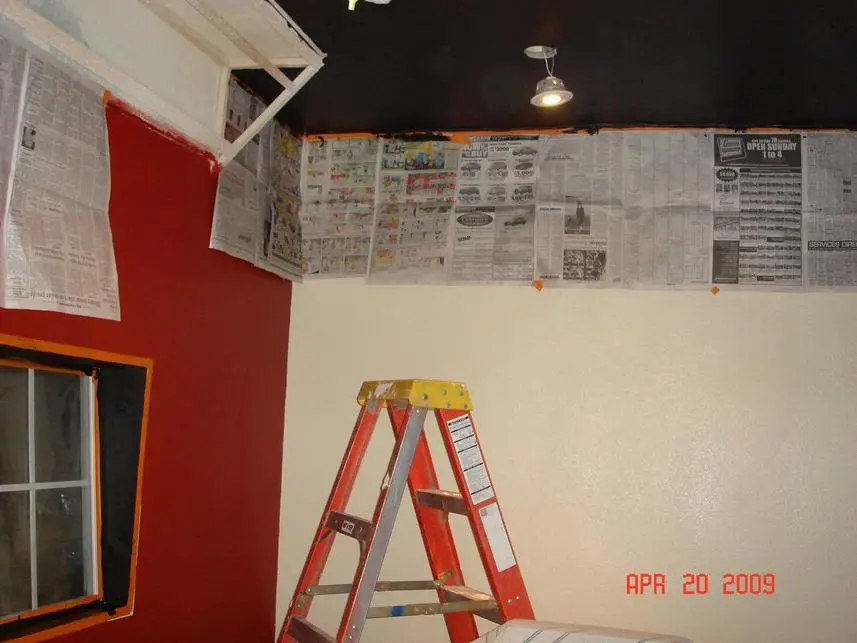

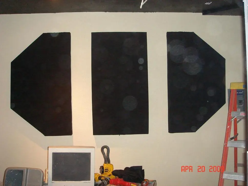

wall treatmenst

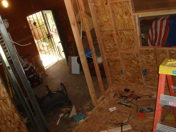

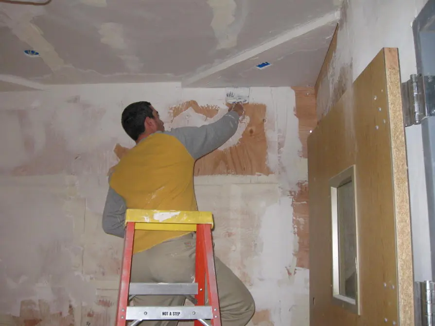

I sent less than 1000 dollars on everything. All donated. THe paint was free, but I am a 49er fan. So it inspires me.... THe vocal booth will be purple.I am a electrician, so on the jobs i am on i ask for left overs of over orders. The two still frames were free. The Solid wood doors were from a hospital. They were throwing them away. All the insulation was left overs or a couple free bags from friends I made on the job. All the drywall was scrape cuts from job sites. It took alot of taping and mudding but mud is cheap.I bought all the wood, but all the screws I use to put it together free.Even the hard insulation in the wall treatments. The A/C guys at work were about to throw boxes of it away.So I put it in my truck. The windows were all lowes return clearance items.It took over two years and I am still trying to find wood flooring so I can move in but, I am happy. Cant wait to play my guitars and drums and all the other stuff that is packed up.

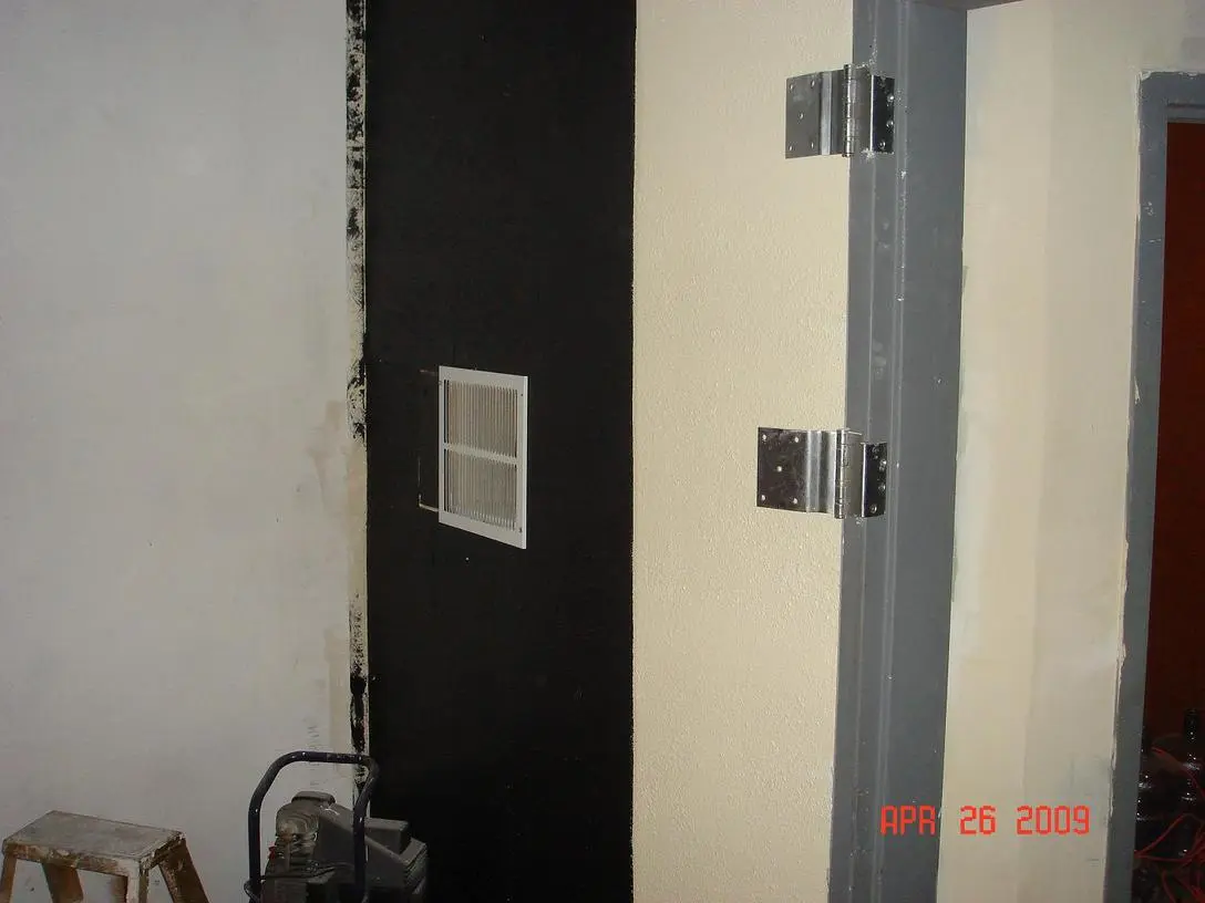

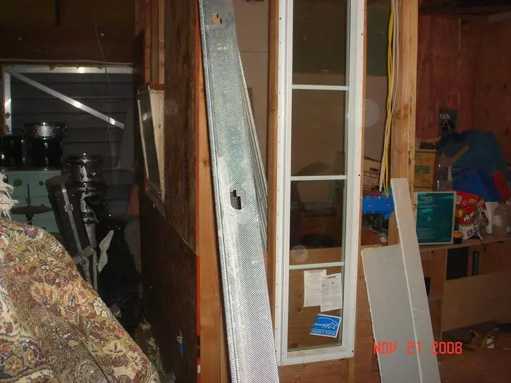

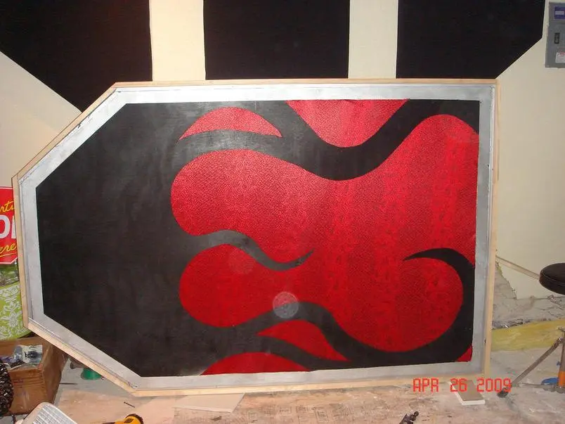

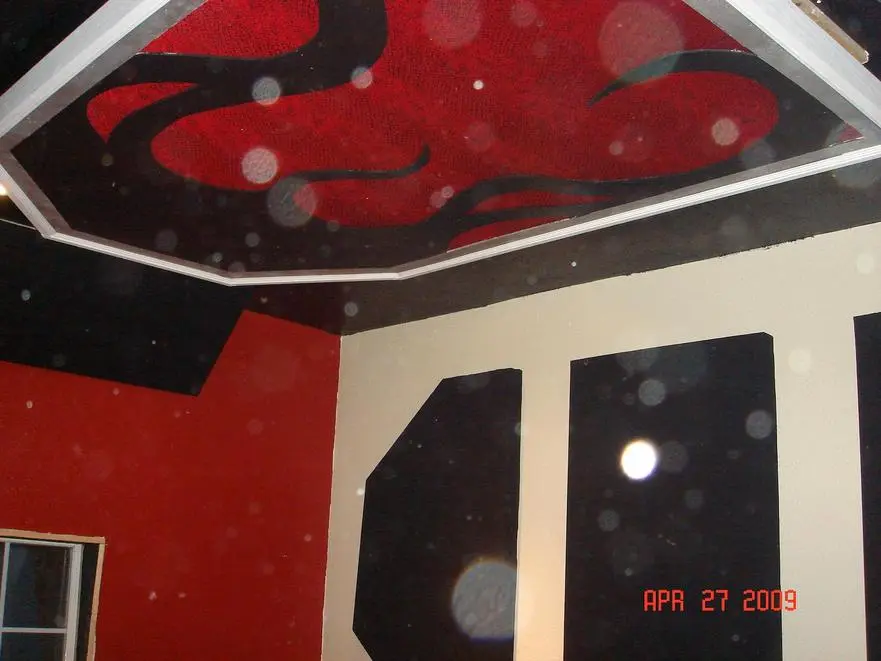

Here are some more Pics. I just built the overhead sound treatment. Its all wood, except for the fabric, which I am not wold on yet. The black wood is 1/8 inch finish plywood. I still have to paint the outside wood white. The drywall mess is still not sanded or wraped all the way. The inside is drywalled, mudd, and taped. It is then drywalled around the outside of the metal studs. They are 2x2 metal studs. So there is an air gapp between the two layers of drywall.THen I put black duct sound absorbers in the duct. It is not connected to the wall mounted a/c, just right in front of it. It works awsome. No noise, no change to my house.

Okay...hold on for a sec...you've got your overhead treatment covered with wood? That's not a good idea. It'll be just as reflective as the ceiling above it...or am I missing something?

Part of its wood most of it is fabric. Here is a picture of it hanging. The room is very warm, and dead. It might not work out right It still might change.

I'd take all the wood off. I agree that it looks cool, but it's doing exactly the opposite of what it should be doing because it's so close to the speakers. What you're looking to do on the ceiling or at the first reflection points is control the short wavelength stuff, which will bounce right off of wood. Wood has a LOWER absorption coefficient than the drywall that's on the ceiling...you're actually doing more harm than good, even if only part of the face is wood.
If you wanted to do that on the back wall, the corners or in the rear of the room it'd probably be fine, but not at first reflection points or on the ceiling.

Yeah it could be a problem, but the wood is the thinnest wood you can get. If it wasnt for the frame to nail to it would bend and start to hand towards the ground. I still might scratch the whole design, and just wrap them like the wall accents. As it sits the wood is about 18" and it sit almost directly about where the speakers will sit. A foot or two off the wall. So I wont get that much indirect sound.I might even cut sound foam out the shape of the design to cover the wood. On the back wall is going to be a fabric wall paper, and I am building a all wood diffuser. Like the ones they sell. I am going to make two of them 2x2.

There are a bunch of designs out there that incorporate frames so the panels don't sag.
About the back wall...don't put diffusion back there. You need low end absorption on the back wall or you're going to have BIG problems at the listening position. I know everybody sees diffusers on the back wall at the big places, but that's always in the context of a comprehensive bass absorption design that usually includes a TON of absorption on the back wall. The diffusers are built into this.
There may be a place for diffusion in your control room (depending on the size and shape), but the back wall is the wrong place for it. You'll create more problems than you'll solve.
