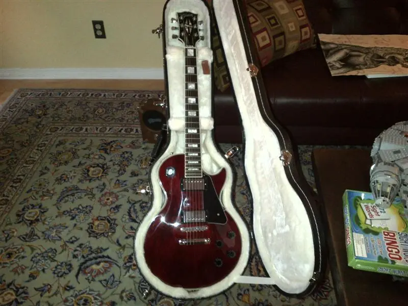

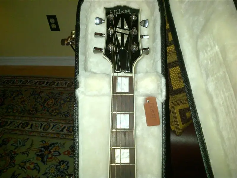

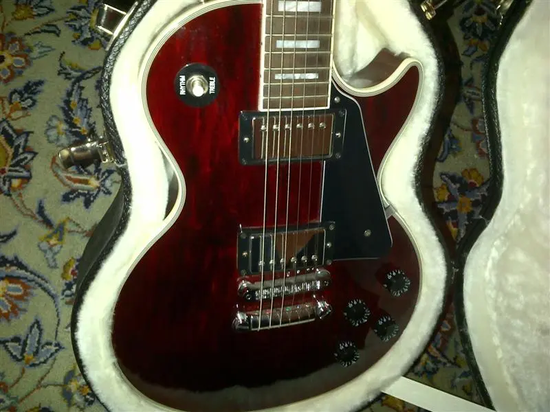

Here's a couple shots when I had just gotten it:
nice pics
who wrapped the strings around the tailpiece?
the case is pretty cool too
its the first guitar ive had that came with a case and its like the cadillac of cases
Previous owner wrapped the strings - I've since gone back to threading the strings through the tailpiece normally.
They say top wrapping the strings helps sustain and makes bends smoother? I don't know. I tried it and didn't notice anything. I put mine back to normal.
There are a few old threads about the merits of reverse wrapping the strings. Most debunking the idea..
I would think that with a tune-o-matic, since the strings essentially stop at the nut and bridge, top-wrapping the tailpiece pretty much does nothing. Maybe I'm wrong. I'm just thinking about where the string actually does its job - which is between the saddle and nut. Maybe it's just a old habit carried over from the fixed compensated bridge days?
I agree ........ I don't see how it could possibly affect sustain or anything at all.
it essentially does nothing other than change the break angle of the string over the saddle.. On a solid body that would do next to nothing acoustically. It may on a hollow body but how much is debatable. Some people love to perceive a difference that isn't there. Placebo effect only...
