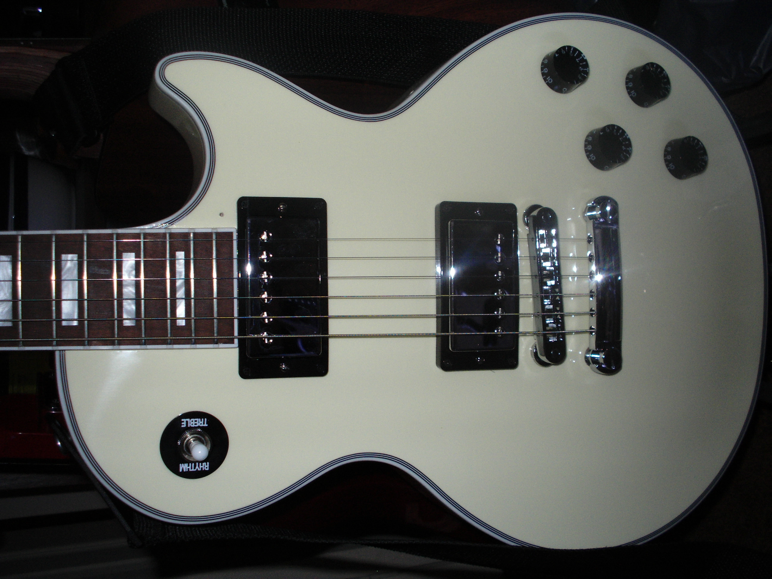

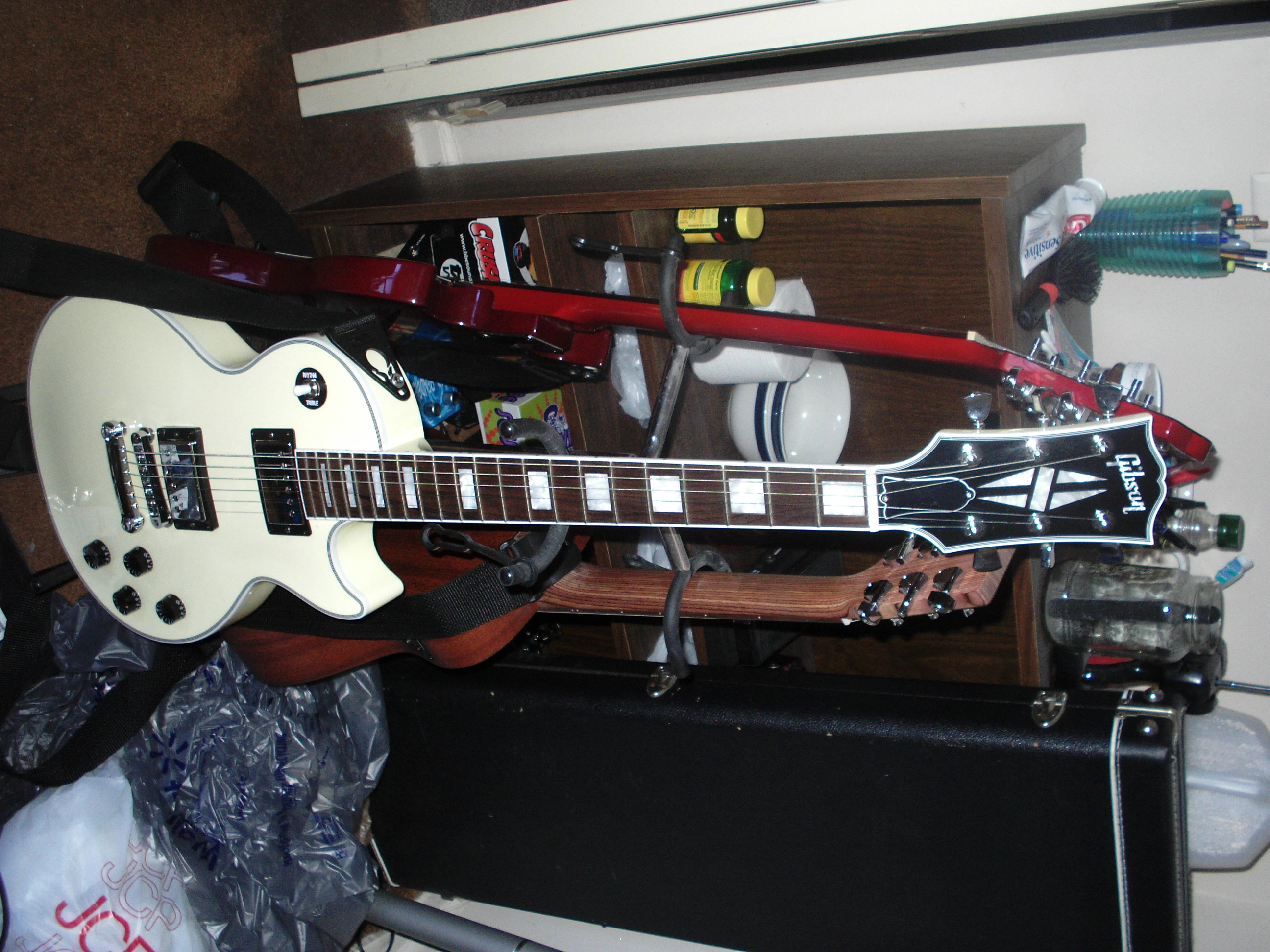

well i got it today and it looks perfect and the setup is excellent
intonation is near perfect and the action is nice and low but not too low
i removed the pickguard

Sweet. That's really nice. Rosewood fretboard? I like it better than the baked maple. Looks great.
That's really pretty.
I have a fondness for white or cream gits.
And I think dropping the pickguard was the right move.
Congrats on a fine instrument.
