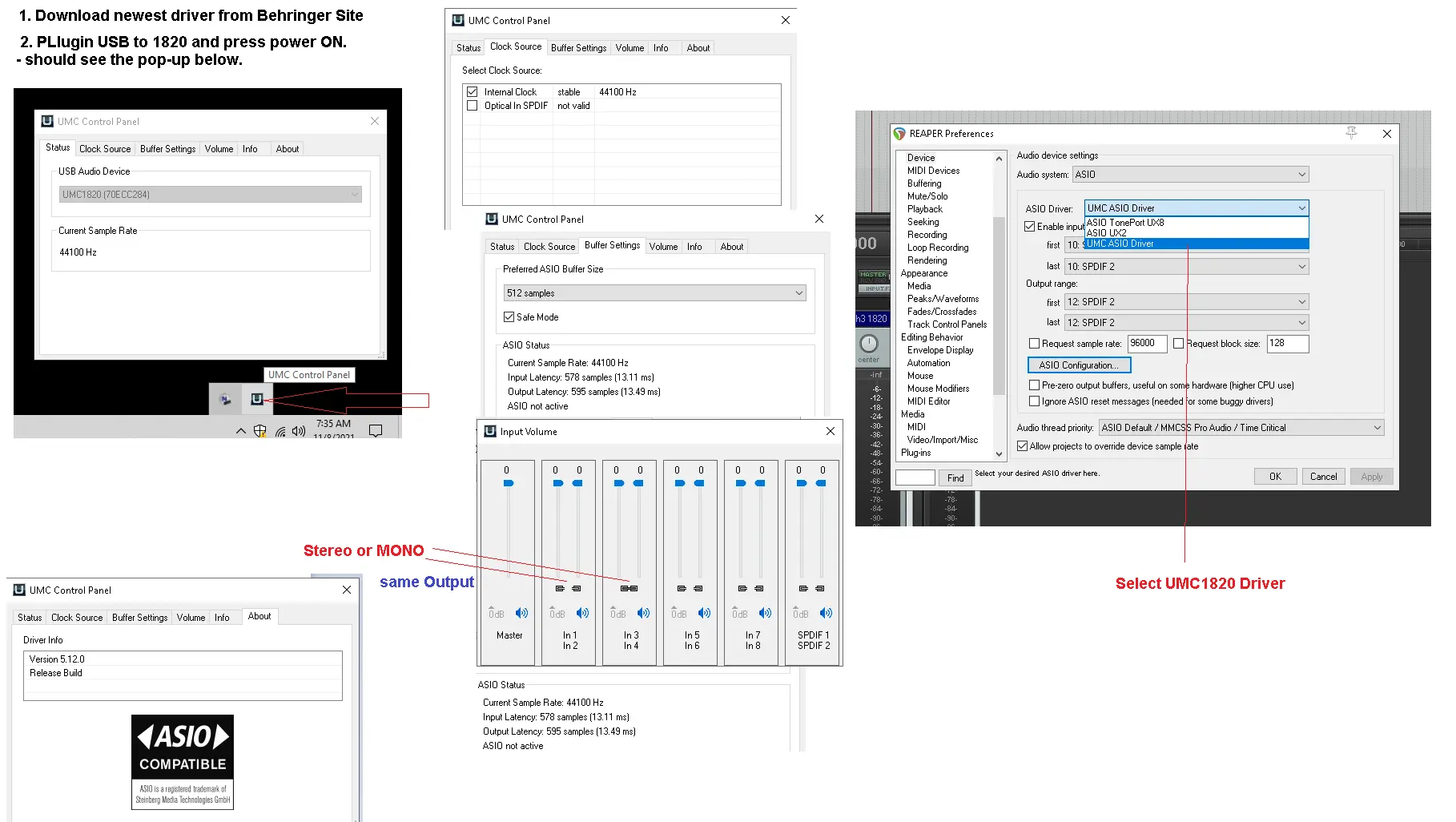

the UMC1820 showed up here. unboxed and plugged in the walwart, USB 2.0 (larger plug) cable, I left the protective cover over the faceplate.
Install-
1) First thing is the knobs seem really sturdy and a lot better than my old Line6.
2) Downloaded the very simple Driver, used the newest version from the Behringer site. ( download to my old WIndow8 pc, with the free Window 10 from several years ago purchased tower)
3) Opened REAPER and recorded some tracks.
approx 30 minutes...very simple and smooth install for me. everything worked
I could be done here, 8 tracks in all showing in REAPER....playbacks in the headphone amps, everything good to go done. 30 minutes.
*remember to turn the P/B Monitoring knob to the right! this is like an Tascam 1641 I had. If its to the left there wont be any Playback to hear!
at 512 default buffer I was seeing 13ms and 128 7ms in my Reaper...I didnt hear any issues with latency though. I forget what my old interface was.

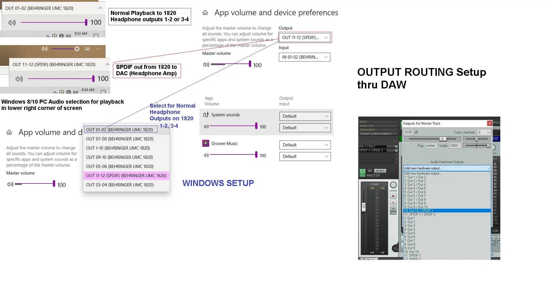

Playback- to a SPDIF outboard Headphone amp..and other Questions?
? then I tried the SPDIF out because my GraceDesign Headphone DAC outboard amp, it needs a SPDIF IN RCA connector.
I fumbled around and found I had to tell the Behringer SPDIF 11-12 OUT in the Windows tray to the lower right. For my playback to work through the Grace outboard headphone amp SPDIF select 11-12 PLAYBACK OUT, but then the Behringer Headphone outputs wouldnt work for OUT 1-2?
The 1820 wants Outputs 1-2 etc for Normal Standard Windows users..and the Music Players work.
Im confused on this...as my old interface had both outputs playing at the same time while the 1820Behringer seems to only allow one choice. Not a huge deal.
The SPDIF /ADAT button on the 1820 headphone area seems to be for listening to incoming and not the SPDIF output.
! The outputs are turned on with the DAW- Reaper in my case. Add New Hardware Output in DAW and now have simultaneous MAIN out and SPDIF OUT.

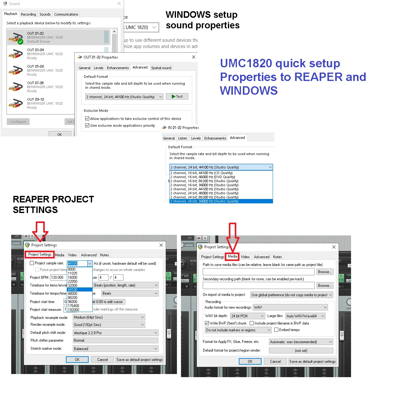

?? I also notice its 44.1 default, and Im not sure how to select 48 or 96, apparently ? my REAPER PROJECT is doing this I assume?
Anyone know? I use 44.1 anyway, so thats fine, but tech gear head...I like to be able to know I can change it if wanted. Even try the 96khz too.
! Setup in Windows and Reaper to select 44,48, 88,96
Its seems this will work fine.

ADD PIC: SETUP for 24/44...48..88..96.....in WINDOWS and REAPER
ADD #2: The 1820 Outputs are activated through the DAW. So my SPDIF Outputs were "turned ON" by simply adding SPDIF to my Reaper DAW Output Main Buss-
