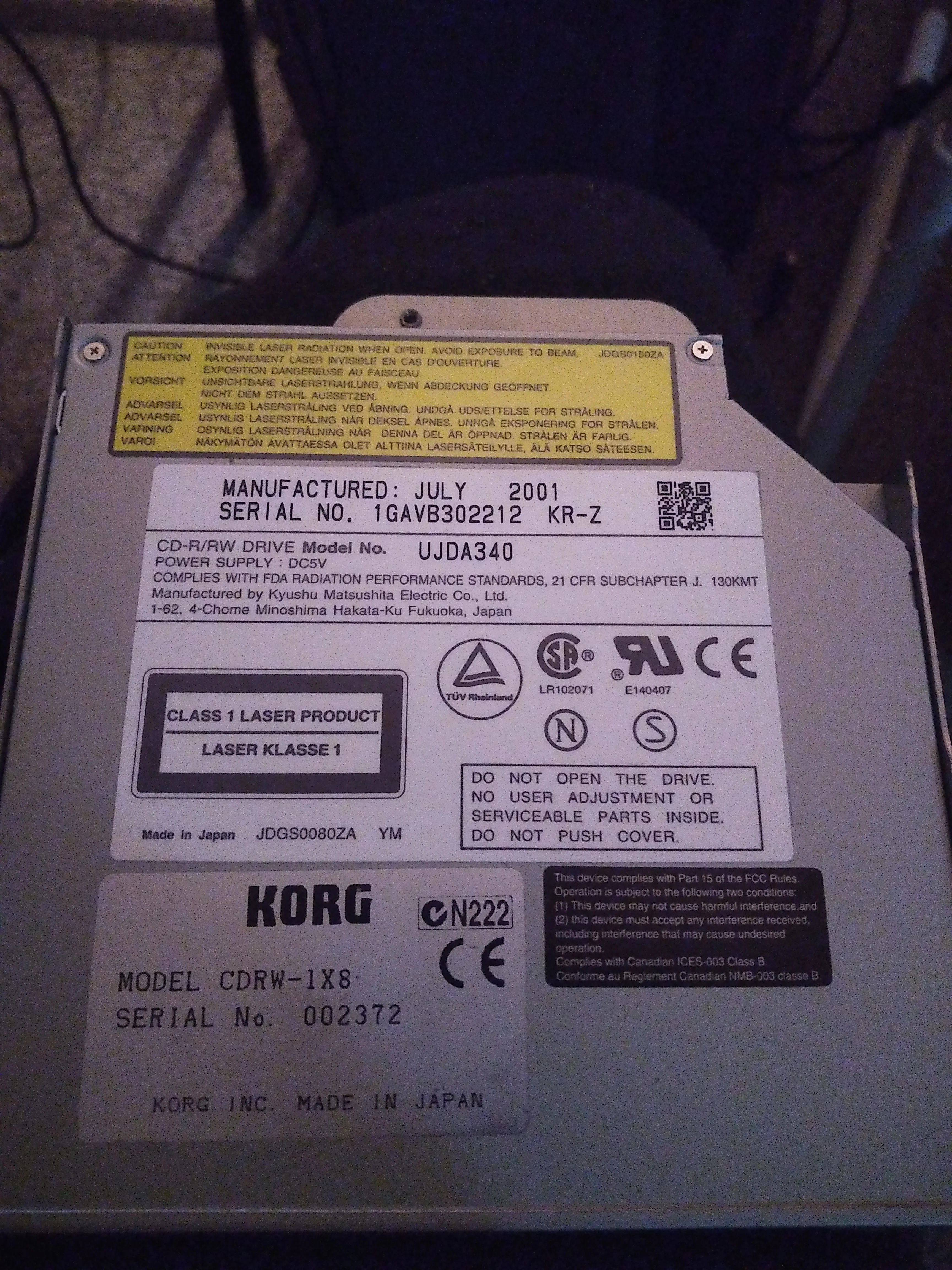

This is the drive
That's not a hard drive, thats a CDRW optical drive!
Damn I already said I didn't know shit about electronics. Lmao So I will have to open the whole thing up to get to the drive right?
unless you have x-ray vision, sadly, yes.
