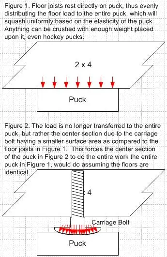

Steve,
I couldn't find our original thread, wasn't sure if it was on this BBS, or John's, or what thread. Maybe I have too much "mud" dust in my head :(
Anyway, I've attached the diagram as promised, and I'm only trying to illustrate a concept here.
This concept is "big" in racing, because point loads generally will cause chassis failure. This is one of the reasons for such fancy triangulation - to spread the load of cornering, weight transfer, acceleration and breaking to as much of the entire chassis as possible at all times. This way, it can remain lightweight since it all the pieces work in unison, rather than any one piece bearing the entire load of the weight/movement/etc.
I had suggested carriage bolts for two reasons - one to make a point load for the reasons stated in the drawing, and second, it is much easier to drill, hammer in a T-Nut, and screw in a carrage bolt than it is to use a hole saw in a drill to bore through the center of a hockey puck. Though, it can be done with liberal use of clamps and such. In fact, one could probably get four rubber columns per puck, if one bores carefully.

frederic,
You can't equate the engineering required for an automobile that's going to race with that required for building structure. The engineers are after very different things.
I would point out here that another consideration that has to be taken into account is the ability of the framing itself to carry the point load. There will be an increase of forces on that point of the member - with less member to handle those forces.
Once we remove the material where the T-Nut is embedded we have just decreased the cross sectional area of the framing - and have to look at the remaining area of the member to determine if it can now handle the shear and bending that will be imposed on it at the point of the nut.
My guess would be that this is going to force you into (at the very least ) the next larger member size..... and from a cost/benifit point of view - may well make it not a viable construction method.
The analysis is not complete just by determining if it works with the puck (or pad) - but has to follow through all of the assembly.

I see one problem with this Puck idea. The elasticity of the Puck VS the elasticity of the wood forced vibrational loads back into the wood (weakened by drilling) defeating the purpose of the Puck. By creating a peak load condition on the puck you will actually compress the puck material into something thats probably equal with a concrete slab. Remember how structural loads transfer and the basics of isolation.
If you drilled a hole partially into the puck and filled it with a medium durometer elastomer you could dampen and control positional tolerances so there is no drift :)

I'm going to show my stupidity (not being a structural engineer)... it sounds to me like you all are suggesting that you SHOULD concentrate the load on the pucks... as in the carriage bolt example...
why? I am assuming two things... 1) if the puck is compressed too much, it will negate its ability to decouple the floated floor from the original floor and 2) you'd also be creating a structurally weak point in the 2x4 member where the shaft of the carriage bolt is into the 2x4.
Just curious.
Velvet,
Re-read my post - that was one of my concerns - you must have missed it (i am an engineer by the way)

Rod,
Yes... I read yours.. sorry... I should have directed it more at frederic.
The only assumption I can make about WANTING to compress the puck to the point of stable compression is that it would elimate the floor feeling "squishy" and still maximize the decoupling... but I'd still be concerned that I have the weight of my floor resting on the remaining inch of 2x4 because I drilled out the rest of it to sink the bolt into the wood.
Granted the wood would compress against the side of the bolt under even load and most likely not break, but in the case of a direct load at the outer edge of the bolt, straight down, I would think it would be pretty weak at that point.

I agree totally... but the assumption is still regardless of the chunk of lumber, that removing material... and then centering a load on the portion of the wood where material was removed must not be as structurally sound as the 2x4 being supported along the enter 3 or 4 inch surface of the puck.
Ideally I would think that it would make sense to take a puck and cut an X in it using a dado cutter or something of the sort and then placing the pucks at the intersections of the 2x4 and the cross bracing members... that would maximize the load support per puck.

Rod is correct, the goals of an engineer designing a race car is very different from an architectural engineer's goal. I am neither, however I have some experience with the former, so I try to draw on logic that I'm comfortable with.
I guess no matter how I slice it my idea sucks :) Maybe it would have been better to suggest turning the puck down on a lathe to an upside down trapazoidal cylinder, so that the 2x4's aren't drilled and weakened and the point load is passed down to the concrete below.
How about we all skip hockey pucks :) heh-heh. Thanks for the good comments everyone, I learned something here. I'll stick to cars :)
