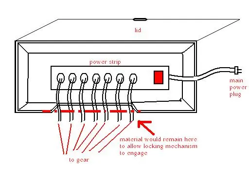

- Build a lockable box to cover up your surge protectors, or whatever power supplies you are using. (buy a 10 dollar cash-box and cut a hole large enough to fit a three pron plug though on one end, and a slot for all your gear power cords to hang out. Then all you do is lock the box when your away.)
Or tie your sister up. LOL :D
Thats a great idea i'll probably end up doing it...but i STILL want to be cool ( :rolleyes: lol) and somehow have it all electronic witht he keypad?

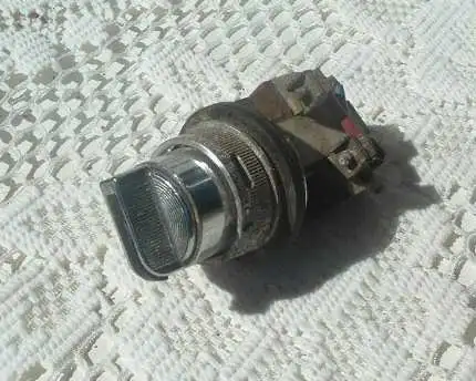

Here is mine. Haven't cleaned it up and installed yet, but it goes in my console power panel. Got it at a local auto junkyard for .50 cents :D
Hey thats a really good idea frederic :) I'll probably end up doing that!! That's really neat. Now how/where is this wired?? :) thanks guys!
It's wired like any other light switch. So, intall it into an electrical box, mount it in the wall or on the console table, then wire a normal 3-prong outlet (59 cents) to the switch, and plug your power strips into the outlet.
It's really just a light switch with the part you "flip" with your fingers missing, and instead you use a metal thing that comes with it to turn it on and off.
