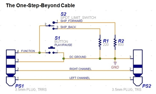

For Dave and others with a bit of electronics know how, this an adapter cable someone came up with, but lends an idea of how the switches function. I'm guessing because of the switches the sleeve ground(4) did not connect back to the interface and the ring(3) was left floating with no connection. There must be adapters for headphones like these so they could be used with conventional TRS jacks(?)
Full article.... http://www.wisebread.com/build-a-cable-to-control-your-android-phone-while-you-drive
