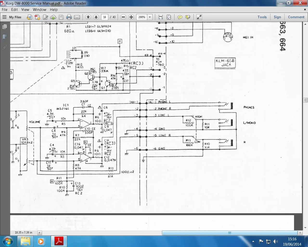

Synth schematics are a bit like rocking h.ds.
But the one I found for a Korg looks pretty standard for deriving a mono sum from the headphone amps?
At this point we're only seeing the headphone amp, and yes it's just two amplifiers doing exactly the same thing to two separate signals. The big question is exactly the hell are those two signals? Can't see it in the schematic, and if the stereoization happens in the digital realm (as it most likely does) then the schematic won't tell us anything about it.

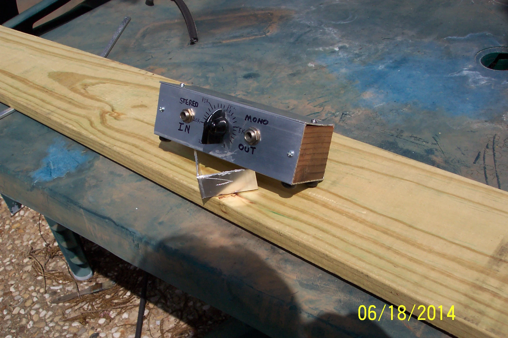

Indeed. Knew it as soon as we had to tweak the junk out of the EQ at the board. Used almost identical schematic to what Arc first posted. simple combiner with 20k resistor...sound guy did the design and work, but I remember buying the 20k resistor at Radio Snack...as well as some other smaller ones 400-500 I think...
It's a Done Deal
It ain't pretty but it works.
Unless I can find some other Mods>>It's done

If it sounds good with the mixer that you've built then to with it. I'm pretty sure you'd have noticed by now if you were losing all the bass due to phase cancelation. The active mixer you linked from AMZ won't help that anyway. The Behringer mixer might, if it has polarity switches on each channel (I didn't click through to check), but if it really was fake stereo like that you'd do just as well to simply throw away one of the channels.
...But the fact that it sounds fine combined with Broken_H's information that it is an actual stereo signal with actually different sounds on each side (low notes left and high notes right) leads to just go with what you've got.
It's a typical budget keyboard for schools with some OK sounds, but they hiss quite badly by proper keyboard standards, and running them one sided really won't muck up the sound that much - with these, I'd just stick a guitar lead in and it will be fine. The kinds of differences we're talking about are a bit lost - because a guitar amp is also pretty naff sounding on keyboards, having a tailored sound suitable for er, guitars. So plug it in, and away you go.
Ashcat>Yeah I get good lows and highs the whole thing sounds good and that 25k pot really works good.
I turn it up as high as I can to get rid of any back ground hiss (until the amp starts to crap out) and then dial it back.
