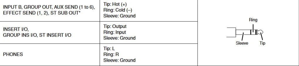

According to the owners manual on the 24/14, the aux outputs are mono balanced outputs. You need to use the Phones output which is stereo.

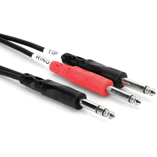

In that case, you could try using the stereo Sub out and use a 2 mono to 1 stereo cable to connect to the Mackie. Note that the output of the Aux and Sub outs are +4dBu line levels rather than headphone level. As long as the levels are set appropriately, it probably won't make a tremendous problem. Or you could use the Group outs, and sent the mix you want to monitor to Group3/4 and your main output to Group 1/2. I do something like that with my MX12/4. The Yamaha lets you select both groups if you want for an input. I sent the PA mix to the mains, and the recording mix to Group 3/4 which is different. That way I can adjust the main output levels without affecting the recording output levels.
