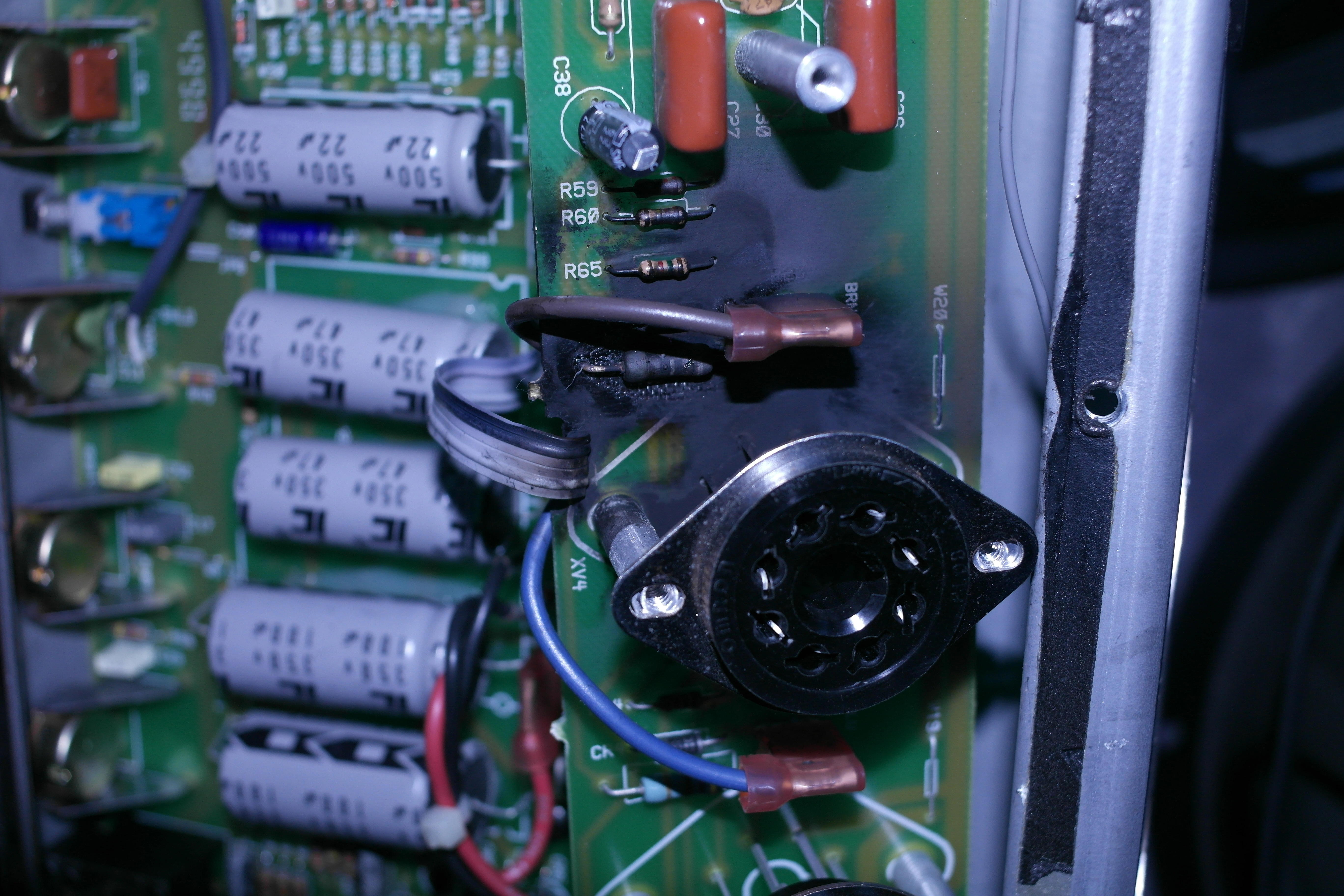

I received a hotrod 2x12 for repair from a guy who said he powered it up to test...played for 5 minutes, went to make a cup of tea, and came back to a room full of smoke.
Some super-logical previous owner had thought well...the amp hums so I'll cut the chassis mains earth connection.
It also seems to blow fuses once in a while so I'll just stick in a 5amp fuse instead of the 1 amp or whatever it was.
One of the valves had shorted internally allowing large current to flow across a resistor. That should probably have blown the fuse and saved the amp but didn't.
That resistor terminated to ground/chassis so the chassis would have been live for the duration.
The damage pictured, was probably worse than it looks with several traces being charred through.
Swings and roundabouts, though. I cut away all the char and point-to-point repaired it, but after explaining all this to the man he asked me to keep it!
His intention was to sell the amp and although my repair is sound, neither of us was comfortable sending it into the wild! :)

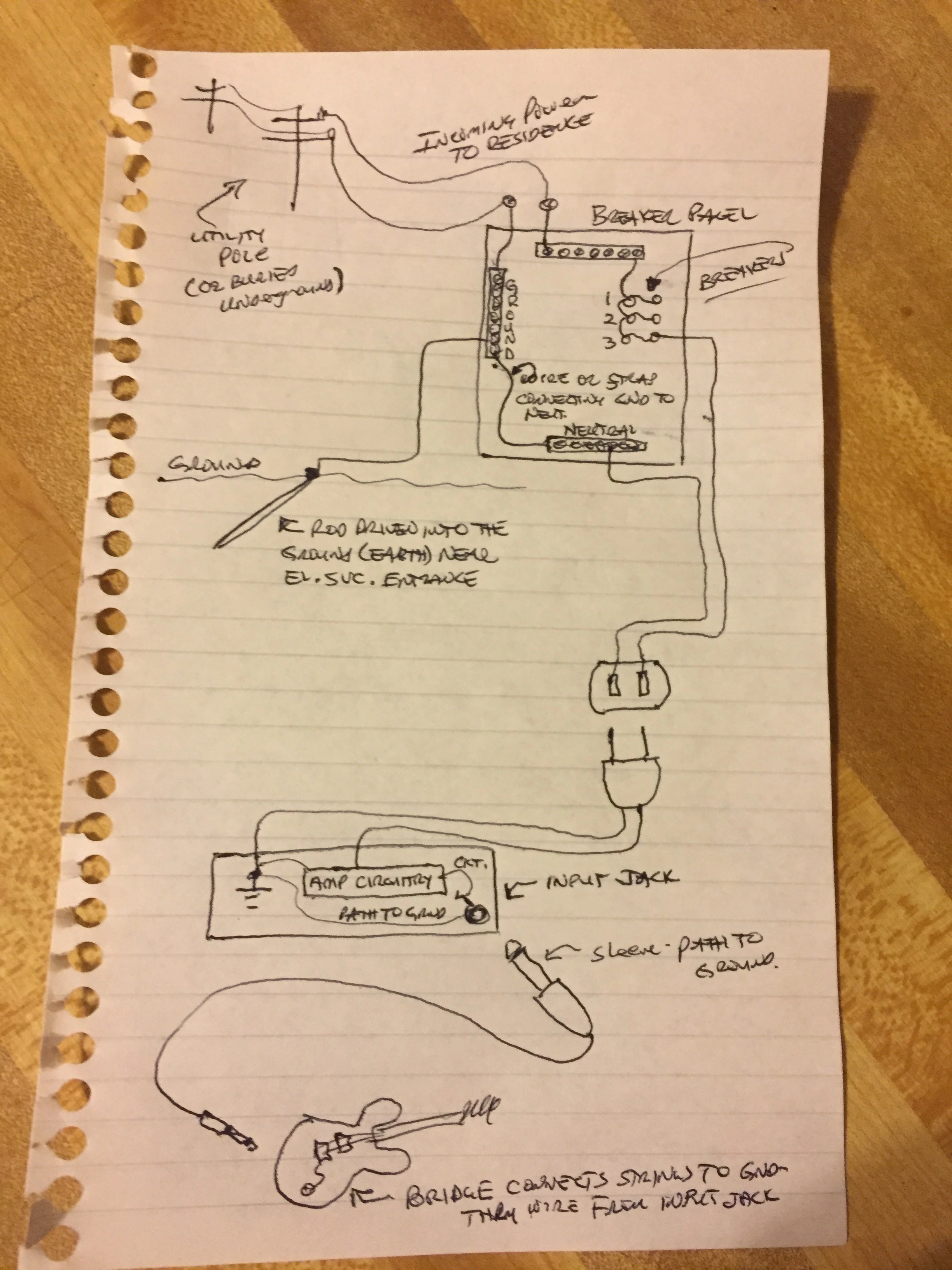

Famous, don't know if this will help or hurt but I thought I might be able to explain the two prong plug thing.
Hopefully you can blow up the extremely elementary drawing and read my writing.
Don't use anything I say here as advice or accept it as 100% accurate, it's only an effort to shed some light onto the subject.
In the US, 120VAC power comes into the house from a transformer either on a utility pole or mounted on the ground. Either way, doesn't matter.
To simplify, we will just talk about two of the wires, hot and ground. Hot (120VAC potential) and ground enter your breaker box or fuse box. the hot side feeds the breakers, and the ground side is connected to earth ground through a ground rod driven into the earth near your service entrance. The ground side is also connected to the neutral bar in the breaker panel. Neutral and ground are at the same electrical potential.
An individual breaker feeds 120V potential to a circuit containing household receptacles, lighting, etc. The wire from the breaker carrying the 120V hot connects to one of the receptacle slots, and the neutral is connected to the other. There is 120VAC potential at the receptacle. An appliance (guitar amp) then completes the circuit from hot to ground through the electronics in the amplifier. The input jack on the amp shares the same path to ground through the sleeve connection. Amplifier ground, neutral, and the ground wire from the input jack are all at the same potential. Being an alternating current device, the amplifier doesn't care where the hot or neutral connects to the circuitry. Just plug in your two prong plug and the amplifier is powered and ready for use. The problem with inserting the plug upside down, or the other way comes from the fact that you have a applied the hot potential to the amps ground circuit. Since the guitar input jack on the amplifier shares the same path to ground as the amp does, the sleeve of the guitar cable now has 120VAC (potential) on it. Then through the ground wire in your guitar connected from the guitar's controls to the bridge, you apply 120VAC potential to the strings.
If you are "floating" above earth, or not directly touching anything that is (bare feet on lawn, lips on mic, etc.) the amp works, you play your bit, and nobody cares. But when you create a path to ground like from your fingers on the strings, through your body, to your lips touching a properly grounded microphone. you have just created a parallel path for 120 volts to flow current through you = shock or electrocution!
When the electrical industry went to having three prong plugs for safety, a standard was created where whenever you plug your three wire device into a receptacle, the receptacles hot, ground and neutral are automatically made to the appropriate connections in the device.
DISCLAIMER: I am not an expert and nothing stated above should be taken for gospel truth. Always observe all electrical safety concerns and consult an expert (not me) before servicing or rewiring any appliance. This is my humble attempt to clarify a potentially dangerous path to ground when an appliance is powered improperly.
Hope this helps and does not create more confusion. Just trying to help[!
Einstein, thank you sooo much for this! This is exactly what I need, and it answers my question(s) perfectly.
Like I said, people would always make claims like:
"The plug was non-polarized. Meaning, every time the amp was plugged in, there was a 50% chance the chassis would have 120 volts on it."
And they would leave it at that, not the adding the remaining important information like: "So if you played your guitar when the amp was plugged in the wrong way ... and then you touched something else at the same time that was grounded, like a mic or the ground with your bare feet, you would get a shock."
Since they didn't say that, I assumed they were implying that, if you plugged the amp in the wrong way, you'd get a shock just by playing the amp regardless.
Your answer makes great sense, and also thank you so much for the illustration. It really helped!

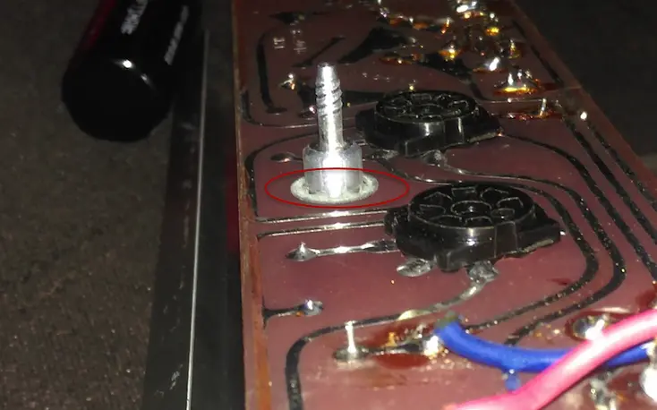

Ok, so I learned a good bit tonight. I got the top and bottom chassis separated and got pictures of that.
Not sure if it's important to you now or not but I can see better how the board is mounted from those pictures.
The circled part is just like a washer with internal teeth. The teeth bend on fitting and act like barbs.
They will come off with force (lever with something thin/flat) and they will refit and grip again no problem. :)
Hope that's useful.
Hope that's useful.
