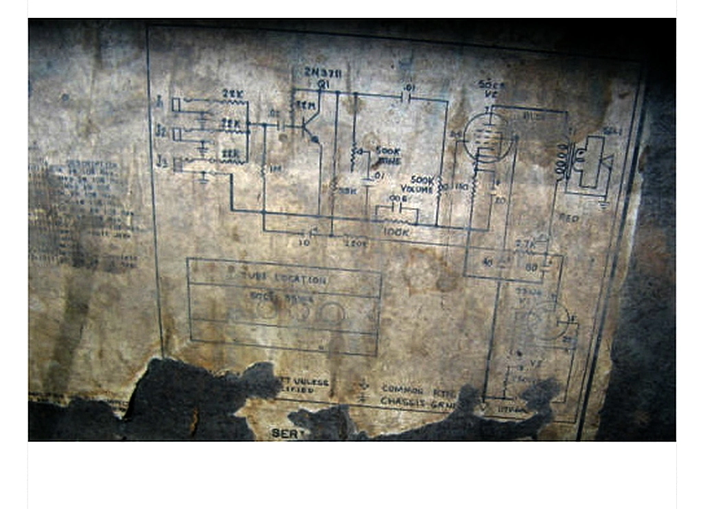

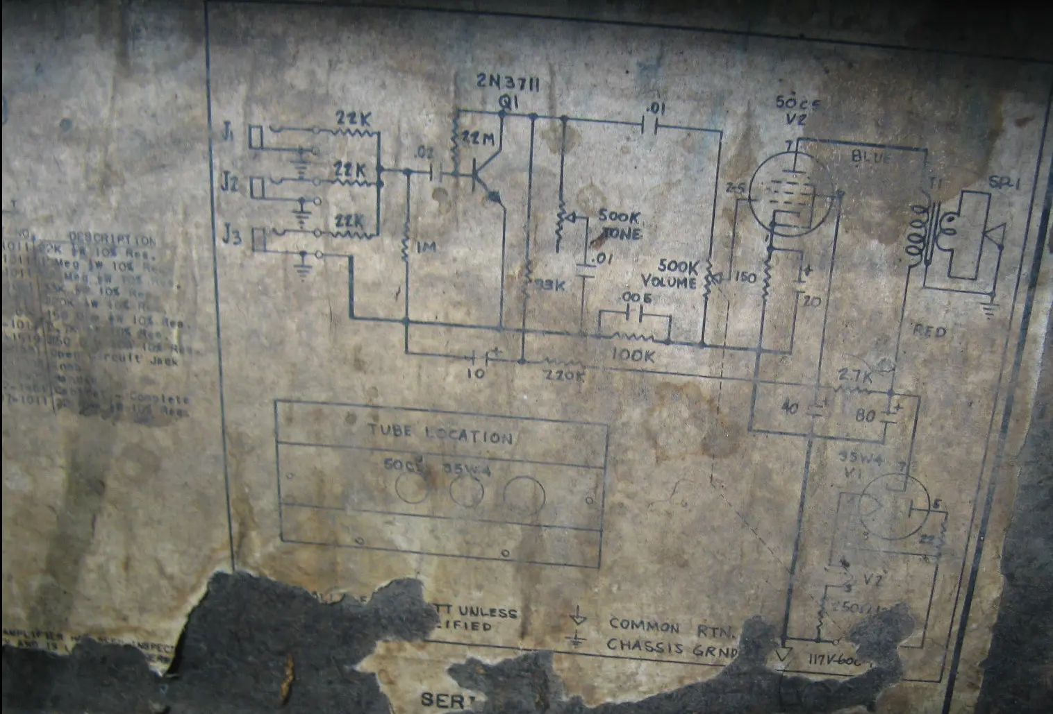

Another oddity of that amp is the usage of the first stage transistor. There is no biasing resistor from its base to emitter. It's almost like it could give distortion with any signal put into the amp. It's kind of wired to be a diode Although the resistor that supplies the collector to base appears to be a high value, so maybe base to emitter self leakage is biasing it(?)
It is self biased, just not as common as to what I've usually seen with a voltage divider biasing.

If it's your amp that has this schematic I couldn't tell if the speaker impedance was printed next to the speaker symbol. Maybe you can see it better?

That is the right schematic, and I can see it better on my amp, but I don't see any impedance on it. I looked everywhere.

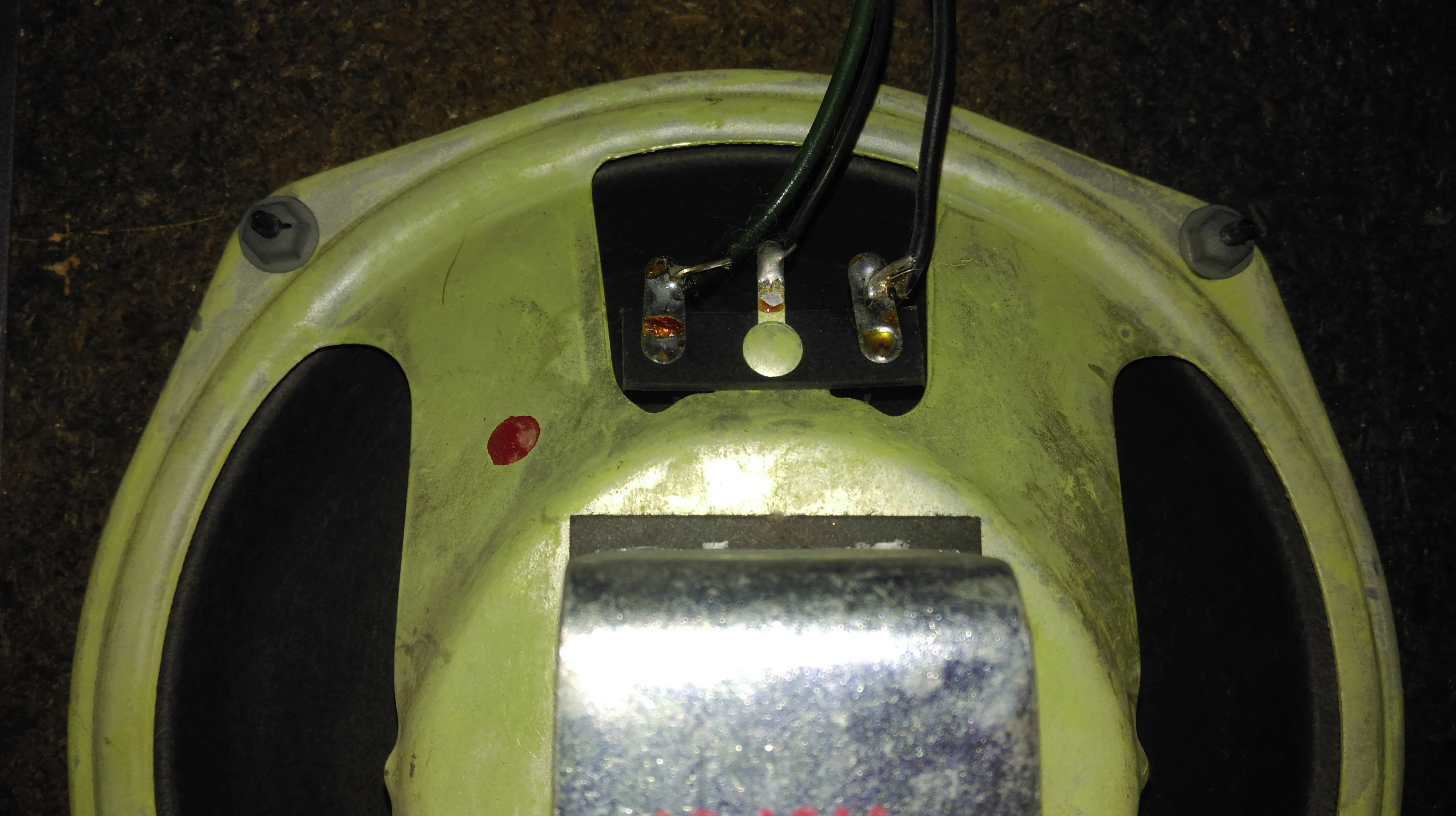

I was thinking about that. But I'm not exactly sure how to do it, because the speaker has three terminals, which I've not seen before.
It's kind of hard to see in this picture, but there's one green wire and two black wires, with the middle one being a little thinner than the outer one.
From looking at the schematic, I'm guessing the middle terminal is ground, the green wire is positive, and the other black wire is negative. Would that be right?
Then if I were to hook these wires up to another speaker cabinet that only had two terminals, would I just need to attach the ground wire to a ground point in the 752 amp?

That third wire is marked on the schematic chassis ground.
L+R in your picture should be output to voice coil, and the centre that chassis tie.
That's easy to confirm with a meter or simply by looking at the voicecoil wires down the back of the cone, but it seems clear cut.
If you're popping in a test speaker it probably wont have a chassis tab so i'd just crimp a ring terminal and fit it with one of the speaker mounting bolts.
Hit the mating surfaces with sandpaper first and confirm you've made a good contact afterwards.
For measuring the existing speaker impedance, disconnect the wires first. Apologies if that's obvious.

Make note of which wire comes off which terminal. A single speaker doesn't care about phasing, but not a bad idea to put it back the way it was.
