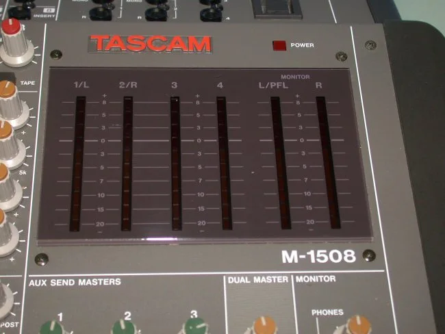

I hate to be the bearer of a negative opinon, but I think your selection of a mixer is going to be an exercise in frustration and disappointment for what you are wanting to do. It is a fine mixer. I'm sure it sounds nice and it has some nice features, but since it is not an "inline" mixer (no way to independently switch between or route line and mic inputs with them connected simultaneously), and no direct outs (an output on each channel strip that sources directly after each channel fader...without it you have no way to push your levels going to tape...you can use a modified insert cable to use the insert jacks as direct sends but they are pre-fader pre-eq...you'll clip your head amp before you are pushing your level to tape to take advantage of that nice harmonic tape distortion), you'll be limited to recording 4 tracks at a time and micky-mousing the patching for tape returns.
Fine mixer, but $500 of gear that is not really built for what you are doing. You'd be better off with something like this IMHO. It is what we technically call a recording or inline mixer. You can take the $300-400 you save and get your MRL calibration tape, demag unit and such. The guys at Sweetwater didn't do you any favors or didn't understand what you needed the mixer for.
Yeah, that mixer. One of our amp techs was just saying the same thing, so I canceled it. I am still having a hard time understanding exactly what a in line mixer is. Not sure if I can afford a new one. Would have no problem buying used, if I new it was in good shape under all those knobs and sliders. Oh Well, the journey continues. Thanks for the tip on the Han-D-Mag. Will have to get one of those in the near future. Recording is "cheap, fun, and easy".:rolleyes:
Inline mixer...
Look at that eBay listing for the Tascam 1508...each channel strip features the following inputs and outputs:
  • Mic in (XLR)
  • Line in (1/4")
  • Tape in (RCA)
  • Direct out (1/4")
  • Insert I/O (1/4")
The MFX8 features
  • Mic in (XLR)
  • Line in (1/4")
  • Insert I/O (1/4")
The Soundcraft lacks that post-fader direct out for each channel strip, and the additional line-level TAPE input. Here's the real trick. Look at the picture below from the 1508 listing...at the top left of the picture you can see a TAPE switch right below the TRIM knob...this is a convenience feature of an inline mixer that allows you to have your tape returns (one for each channel strip) permanently hooked up for the mixdown stage or for monitoring during overdubbing. When you want to "listen" to a track from the deck you simply depress the switch and now the signal going to the TRIM knob is no longer the MIC or LINE input, but the TAPE input. You can still leave all your other input sources connected, but you've switched in the TAPE input with that switch...multiple sources connected "inline" to one channel strip...the other thing is down in the AUX section...The aux sends on this mixer can be switched to source their input either pre-fader or post-fader from the MIC or LINE input, OR the TAPE input. This makes it possible to have mics or line-level sources connected to a channel strip and be mixing those to the direct outs or group or master outs and independently sourcing the TAPE inputs at the aux sends for monitor mixes during overdubbing. Does that make sense?
The biggie that the Souncraft is missing though is the direct outputs. Your TRIM knob boosts the source signal to a nominal operating level so that it is as high as possible over the noise floor of the mixer. Then at the end of the channel strip is the fader which sets the level of the signal as it leaves the strip, either to the direct out or on to the mix buss(es). In this way your level control is independent where it comes into the mixer and where it leaves the channel strip. This is important. Group and master faders give even further control of the level if needed. The only way for the signal to come out of an individual channel strip on the MFX8 is to make or buy a special cable that turns the INSERT jack into a direct out, but the source of the INSERT jack is typically in between the TRIM pot and whatever comes directly after the TRIM pot in the signal path, so your only level control is the same as that which you use to set the nominal level coming into the channel. That is typically going to be around 0dBu or maybe +3 or +6...depends on the mixer...something like that. That is clipping level for the head amp that the TRIM pot controls. Well, sourcing the send to the tape deck right at that point is going to be a much lower level than a typical tape deck can handle...think tape hiss and missing out on all that juicy harmonic distortion. Tape sounds good in part because of that harmonic distortion and that's why you want to have the flexibility to control your levels to tape...maybe your peaks are +9, +12...+18...depends on the deck, the tape, the setup, and the source material and what sound you want to reach but you get the point. The MFX8 has 4 group outputs, so that is why I'm saying you'd only be able to send 4 good signals to the deck at a time by routing 4 channels individually to groups 1 ~ 4...the group out jacks are all post-fader...direct outs for the groups if you will. Yes you can get 8 channels to the deck at a time with the MFX8, but they would all be pre-eq, pre-fade and so on. Very limited. That is more appropriate for DAW work since converters distort at 0dBu anyway, and most do their mixing in the DAW anyway so pre-fade, pre-eq is no big deal. Its different with tape.
If I were you, I'd try to find a Tascam M-308, M-312, M-1508 or M-1516 local to you. The M-300 series mixers have a particular following because they were heartily built, relatively good sounding mixers and really were feature packed for their size. The 1500 series are great as well, and may be less problematic at this age just because they are newer, but I don't consider them to be as ruggedly constructed. Equally impressive in features though, and good sounding. All of them were well-built though and don't assume that it will automatically have problems due to its age. For any of these mixers you will spend 100's less than what you were looking at on the MFX8, and they are built for what you are doing.
Good luck finding a new small-format inline mixer truly built for 8 or more track recording, and if you do find it its gonna be $$$.
My 2p.
