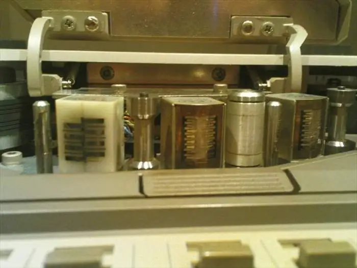

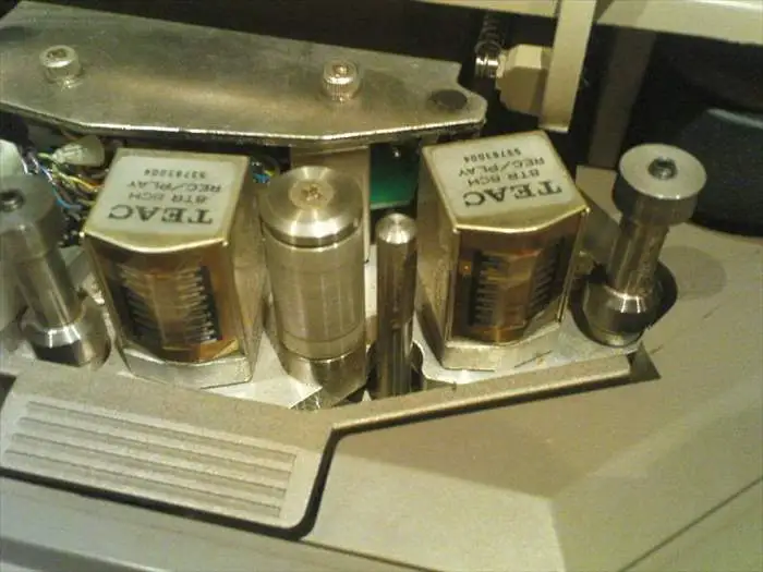

Tascam 58 heads, what do you think of these ones guys?

Sweet beats, welcome!! I've conversed with you in post over at TASCAM forums, I'm a member there too. Congrats on your 58OB. CJacek and others here have been a blessing for me as well learning about calibrating my r2r TSR-8. I appreciate your input from my questions on Tascam Forums as well. The heads on your 58 look worn but very useable for sure. Wear seems even too and that's great. I've looked at others since getting my TSR-8 and am still blown away by how lucky I am to have gotten one is such good shape. Congrats and welcome again!
A trick of the trade: To get a better view (and pictures) of the heads set an index card below the heads on the deck of the machine so that light reflects off the index card and back on to the heads and you see the reflection of the index card rather than a reflection of the deck. This will give a much better shot of the heads. :D
I thought they were a bit worn & might need a relap?

trancedental, I concur with other's statements about the heads on your 58. They've definitely got life left but do show wear. Go to analoguerules.com and look at the "What BAD HEADS Look Like!!!" link. The big visual indicator of a bad head is the gapping. Can't see anything like that on yours, though it would really take a little better picture quality and lighting to know for sure. mamm7215 is right, the wear is very even and that's good...but what is going on with the right tape guide? I can't tell from picture for sure, but do you have some uneven grooving there? If you can, try Richard's index card trick and put up a couple more pics. They don't look physically ready for a relap according to what I've seen and read (unless there is gapping or you can't bring the deck into spec on a calibration...those are the two biggies that tell you for sure).

Another trick of the trade: Many years ago I had a marking fluid (can't recall what it was, but it was black) that I used to put on the heads and then run tape over the heads to show the wear pattern. The mark would disappear in the wear pattern as the tape ran over it leaving an exact wear pattern very visable to the naked eye (or the camera). After verifying the wear pattern I would clean the heads to remove the remaining marking fluid.
trancedental: While I agree that a better picture would help, I can immediately tell that both rec / play heads show a significant flat spot, wear pattern. It looks even though. The tape lifters show substantial wear and I too wonder what's going on with that right tape guide. If that's uneven wear, as sweetbeats pointed out, then it's rather severe. That's not good and would otherwise backup the fact that the heads do show substantial ware.
Do the heads need a relap? It's hard to tell how much metal is still left but usually if you can't get the recorder to align properly, no matter how much you tweak, then it's a candidate for a relap, if the gap is not showing, as sweetbeats mentioned. If I had that much wear on my machine I'd want to compensate by doing a full calibration, at least an electronic one, freq response, bias etc....
We do need a better picture of the heads and tape guides.
Along with Richard's index card tip, try to mount your camera on something stationary and, if possible, use night shot mode and try to open the shutter for a bit more time. That way you'll have a bright, sharp pict.
