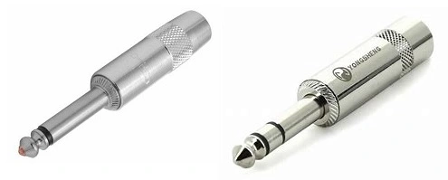

Do both tips look like the first (TS) or second (TRS) of these.

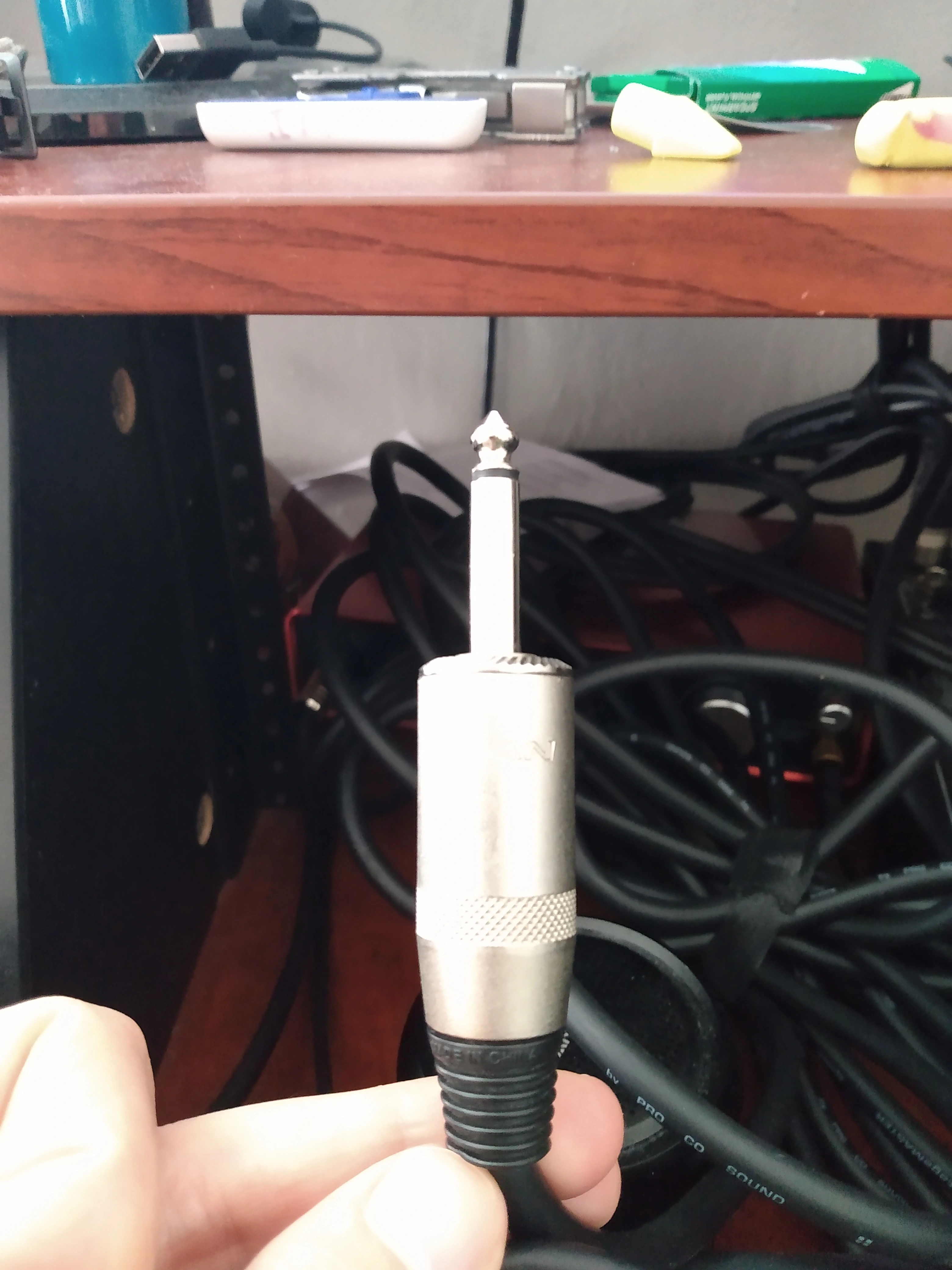

That's a TS line.
You may need to use a 1/4 TS to 1/4 TSR TRS adapter, or cable with TS/TRS ends. Not sure about your Focusrite interface, but my Tascam's L/R Outs use 1/4 TRS.

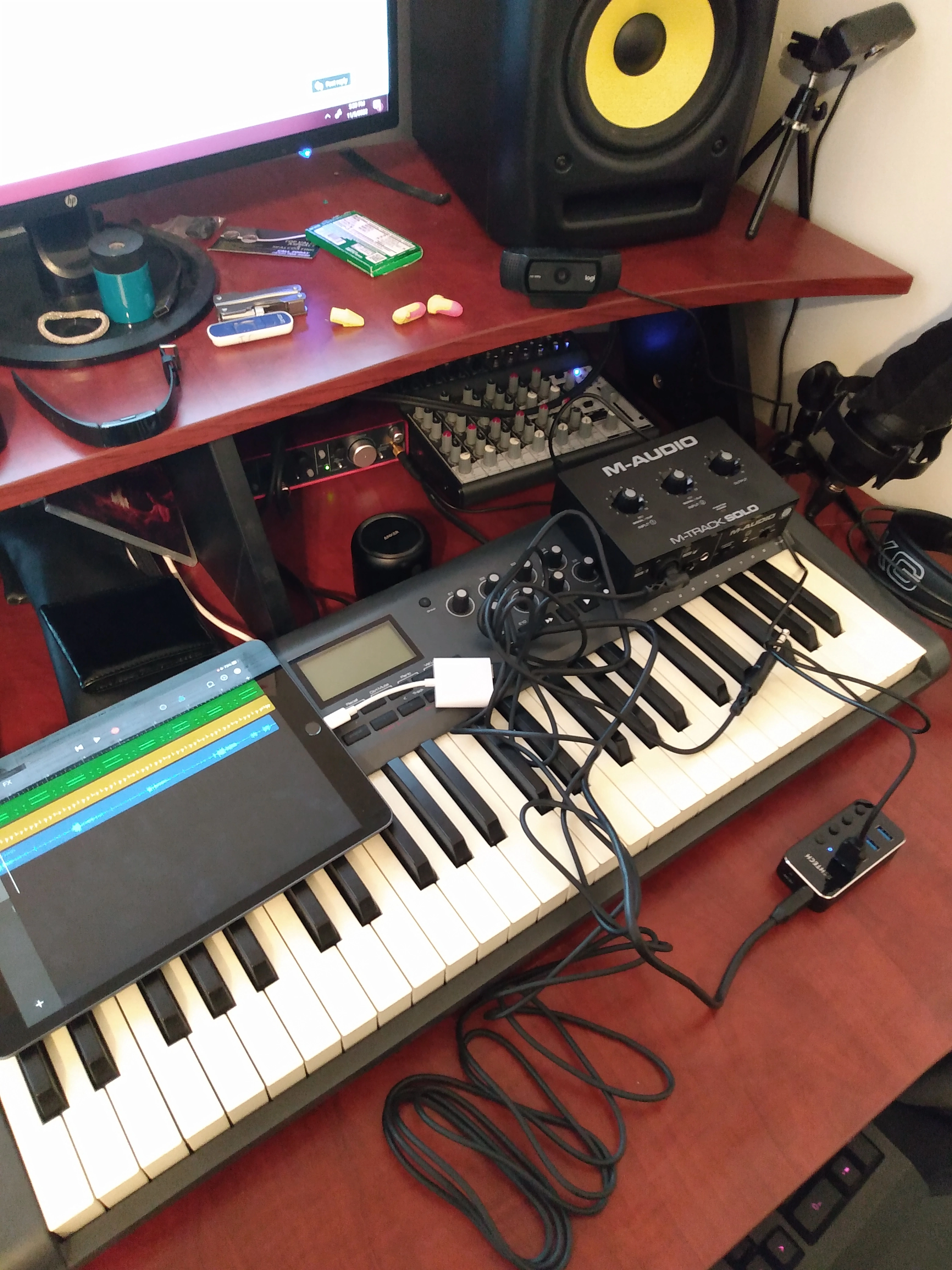

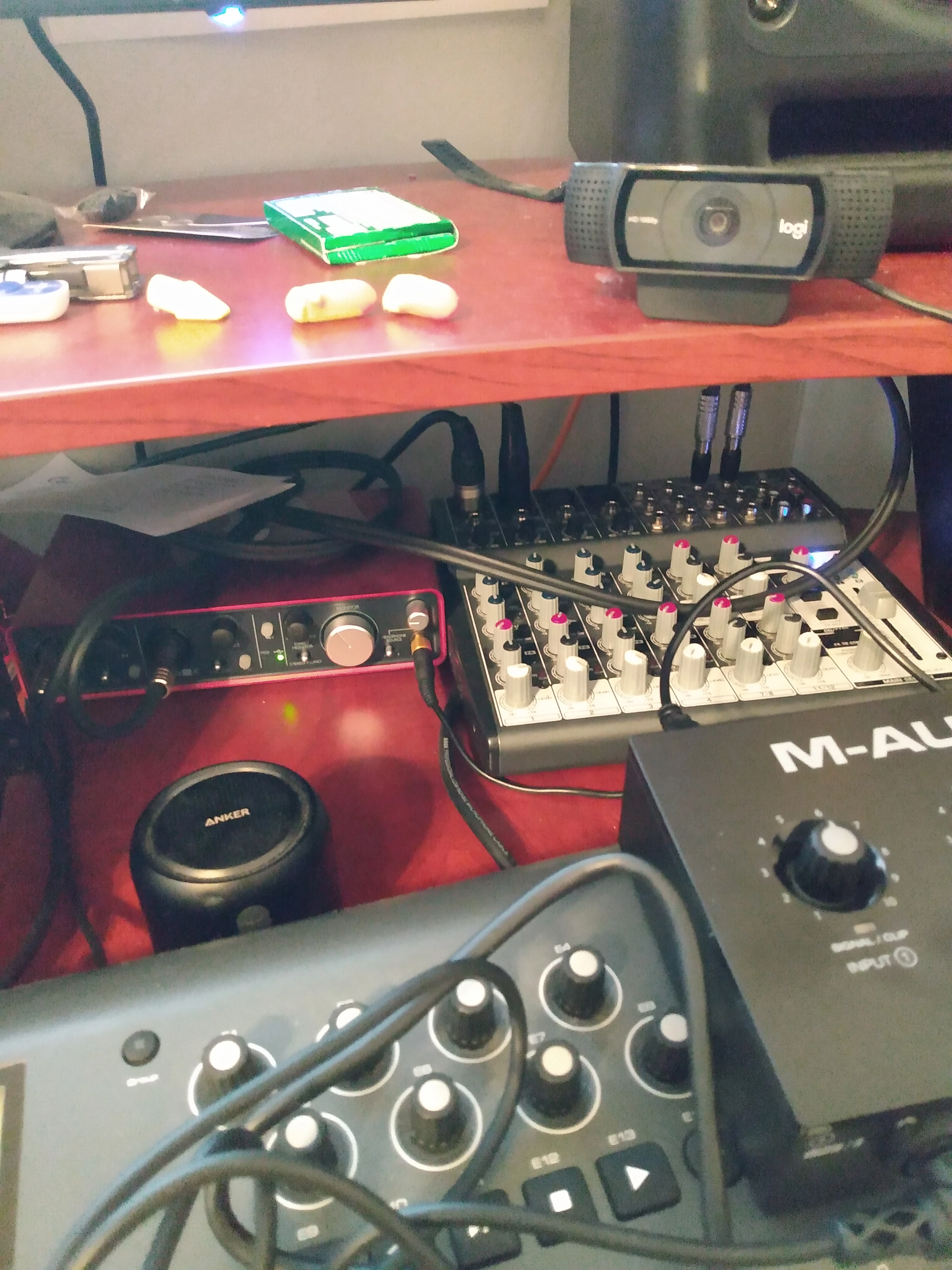

I know it's a mess of wires, but I took some pics for a visual.
I'm trying to play the music from my iPad which is hooked up with an adapter that feeds to a USB hub. The hub also connects to the M-Audio audio interface.
My Behringer Xenyx 1202 has main outs going to my Focusrite audio interface (which is linked to my desktop PC). The main outs go to the two line-ins in the Focusrite. Monitors are linked to my Focusrite audio interface.
What am I missing? Any thoughts?

Do you hear any sound from the iPad when you plug headphones into the M-Audio interface?
I just hooked up the RCA main outs in the M-Audio interface to one of my monitors. That's a work around, but still want to figure out how to get the original mixer idea to work.
OK, so now I've figured out how to get the iPad/M-Audio interface to go through the mixer using the RCA white and red in (on the mixer) and pushing the CD tape to mix button. That said, no sound out of the monitors. Maybe the better question at this point is, if I did a live show, what do I hook my audio interface up to?
