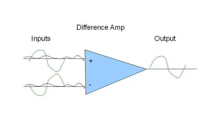

			This is correct, what happens at the Input is.. there is an electronic circuit called a Difference Amplifeier which will amplify the Difference between the two signals . Any noise / electrical interference coming from other equipment like lights ... would be found in phase on both of the signal wires , because the Difference Amp circuit only amplifies the difference between the signals on the two wires it thus filters out the Noise / Electrical interference because this is not out of phase on the two wires......
Make sense?View attachment 65657

			the two wires carrying the signal are identical and the screen is used only for taking away unwanted interference. An unbalanced cable will commonly use a single coaxial core screened wire which uses the screen as the return path for the cicuit and, as the screen and the centre wire are not identical will not be balanced electrically. The impedance of the two will be different.
