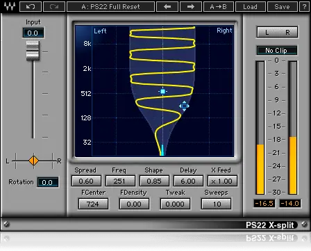

Yeah. Cudos for willingness to experiment, but overall bad idea. Here's a much better way to do this.
