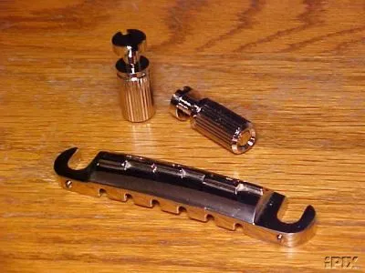

Even the "Historic Gibson" true Gibson replacement intonated wraparound bridge from the same site as the picture above has fixed intonation, optimized for a wound G.
I'll try the Stew Mac. My big concern with it is the statement that it's made for non-staggered studs (when were those ever used? :confused:)

You can get a replacement wraparound bridge with a raised line on top that will approximate the compensation for intonation that you would make with a tune-o-matic bridge.
Right - but the only ones I've found that have the right thread and bushing size are designed for a wound G string, like the picture below. If you could provide a link to one that's intonated for an unwound G, please post it. :)

Now to the guitar. I did sent back the GF bridge that didn't fit. I received the StewMac bridge on Saturday and installed it.
First I reinstalled the orginal bushing that I had removed (after first verifying that the stud threads were correct), and made sure the other bushing was seated properly. The StewMac bridge wasn't a perfect fit, either - the stud spacing was ever so slightly too narrow. Fortunately I still have the original bridge studs, which are slighly narrower where the bridge fits, and this allowed the StewMac bridge to slip on.
The intonation is not perfect. The adjustment screws are not quite long enough, so the fretted notes at the 12th fret are slightly sharp across the board, but I could at least get them consistent from string to string. Regardless it's pretty close, and on playing it works just fine. I was able to set the string height correctly and so the action is still very good. The neck on this guitar is very fast, so it's lots of fun.
