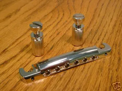

I'm afraid the StewMac bridge may not be entirely acceptable, either. Even though it has the correct stud threads, it follows "the original design for a wound G string and non-staggered mounting stud placement." Well, my G is unwound, and my mounting stud locations are staggered, so I may not be able to get the intonation anywhere close.
I may just end up with a solid bar, non-intonated, like this:
A wound G will require the saddle being set back a little further than the unwound, that's all. If the intonation is adjustable the bridge should accommodate the difference.
On the one I ordered, it's not adjustable.
