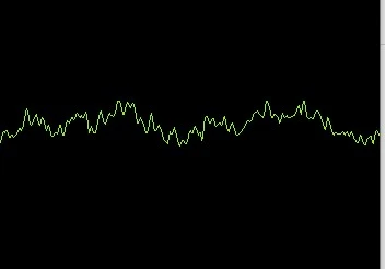

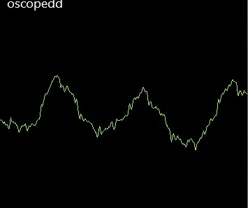

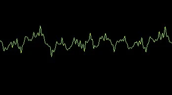

I make a mix. Use the SWS loudness tool. these are same section at -8lufs. I try to filter the track to clear up the wave. Then slightly increase its volume to cover the loss.
Starts like.
Start filtering
at about 100-3000 it melds with the bass
You want me to make video? My ears are in constant use. As are my tools.
