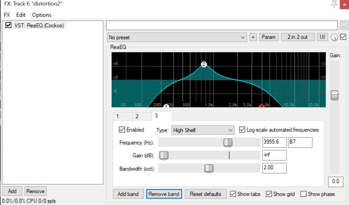

Like...draw a tit in the EQ GUI box? Cut at 4k, boost at 800?

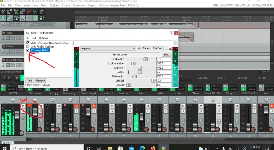

Ok. How about if I should use the limiter on the drum track at least? The spikes will clip before the meat of it. If you have a drum VST use it, and apply a limiter in Reaper. Doesn't that sound right? People say t o use my ears , a limiter in the track sounds right and it helps catch the spikes.
Is make up gain a necessary thing? I always apply some to equal out the volume loss from using a compressor. Perhaps that is wrong.
that EQ is pretty extreme, and I am surprised the guitar sounds as harsh in the high end with an EQ like this? It must have been really bright to start with? You don't really need to high pass any higher than 150, anymore than that will destroy the body of the guitar, I think you could probably get a great mix and low end even with the hpf set as low as 80hz, this would be my starting point by the way, if I struggled too much to clear out the low end I would raise it to 100 and maybe a bit more if I wasnt satisfied, I could end up as high as 150 on some mixes but I don't think yours calls for it, but honestly. 800hz is far too extreme., if you have too much low end buildup do a wide bell cut so you have far more control, wiping out the low end is not necessary, but turning it down will be.
It's very typical to set a low shelf filter at 220hz, hpf at 80hz (steep), just listen to your low end and pull down the low shelf filter until you get a balanced low end. Don't HPF at like 220hz to achieve the same ish result because those frequencies are important to a good rhythm guitar sound. As DMC said above, cuts at the typical 350hz and 800hz are normally needed. You should be listening to your high end while you do this though to make sure that you dont end up with a harsh guitar with no body. If your low end feels right but your high end occasionally gets harsh. leave it where it is then control the top end (4khz high shelf filter De-essing) to duck it in when it gets too much.

I use a limiter pretty much everytime on the drum buss, but that would be after I have a good mix going with EQ and basic compression. It won't really help you, and some would argue that using a limiter at all is a trade off with making something sound a tiny bit worse to squeeze a tiny bit of volume. Very insignificant in your point of the mix because you are not at that point of finishing up yet.
If you are done writing your drums, bounce it down, it will save CPU, better yet. Bounce it down like a real drum kit, this is what I do when writing stuff in EZdrummer. Then you can really dig into the tracks and mix it like a real drum kit, add your parallel compression track, automate each drum to flow with the song. and above all, PHASE! Especially if you have layered in another kick.
edit: Oh and if your drums are clipping, open up EZdrummer and turn the master volume of that vsti down. Let it hit at around -10, or -12. one all of your other tracks are balanced to the drums your master will probably have over 5dbs of headroom. But bouncing it down to each track similar to what your in-built mixer in the EZdrummer plugin has is definitely the way to go. If you can be bothered how to work it out in your DAW, otherwise forget it for now. it's not completely necessary. I just like that extra control. for eg: I cut lots of 110 and 350hz from the kick, if I was to do that on the track then I would destroy the snare drum by doing that. Then if I wanted to boost the top end of the snare, Hello washy cymbals. Etc. I mix drums to sound artificial and less organic, I prefer that sound. Compress the drum room mic and low pass to take the cymbals out of it, then I high pass the OH's so I'm pretty much leaving only the HH's and cymbals in and essentially use the OH mic as a cymbal mic. I would just be pulling my hair out if I had to do that all inside EZdrummers in built mixer. And it would be too intense on the cpu, even though I'm sure my computer would handle it.
