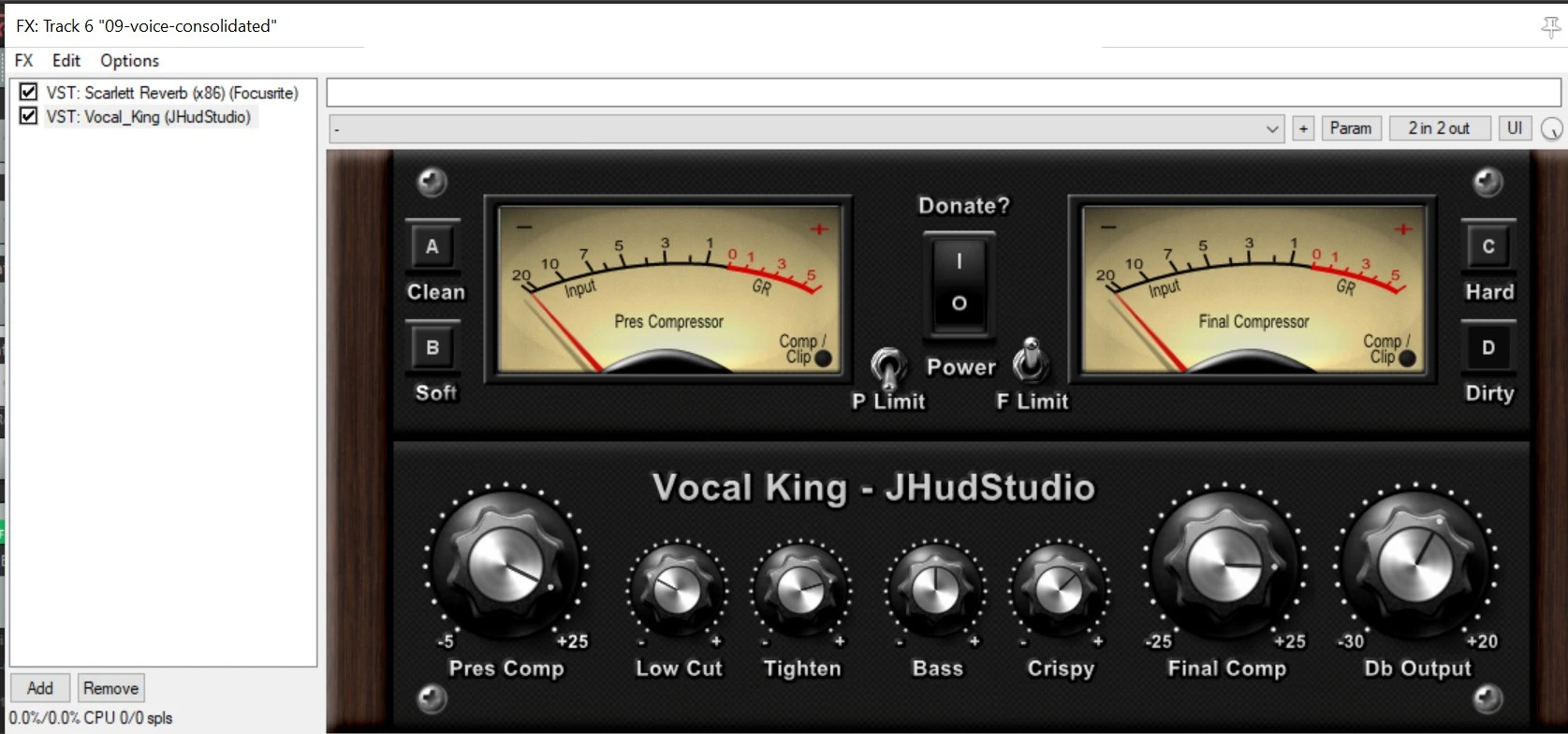

Get your vocal back in there, I can't judge anything without the vocal. But for the arp, I am treating it at a part of the rhythm guitar group, rhythm guitar got the mids and bottom covered, arp can give you the nice highs. The arp probably needs to come down in volume further still though, let there be plenty of overlap though. don't go crazy.
Get a balance where your guitars sound the same in volume with the faders, use EQ to create further seperation, and to balance brightness. To me the arp stole ALL of my attention, it's just too loud and big.
If you like your vocal buried, as do i. it's fine. but you need to make it big, lots of parallel distortion, saturation on the main track, timed delays, stereo stuff, thickening. You will have the illusion of it being louder than it really is. needs to be dense, lots of compression, and some limiting even, parallel compression track, parallel octave track, some noise, etc, otherwise you will forever be struggling to find a fader position. it will be impossible in fact without the appropiate big track to small track ratios.
