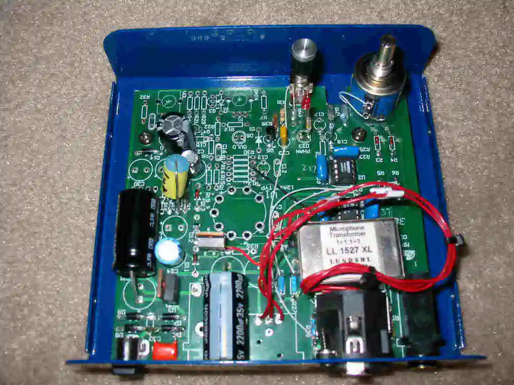

It's a simple thing really but boy what a difference. I used a Lundahl transformer for input coupling and a Burr-Brown INA217 instrumentation amp. I used the PC board I stripped from a Bellari MP105 and it's housing.

Here is a picture of what I've made.

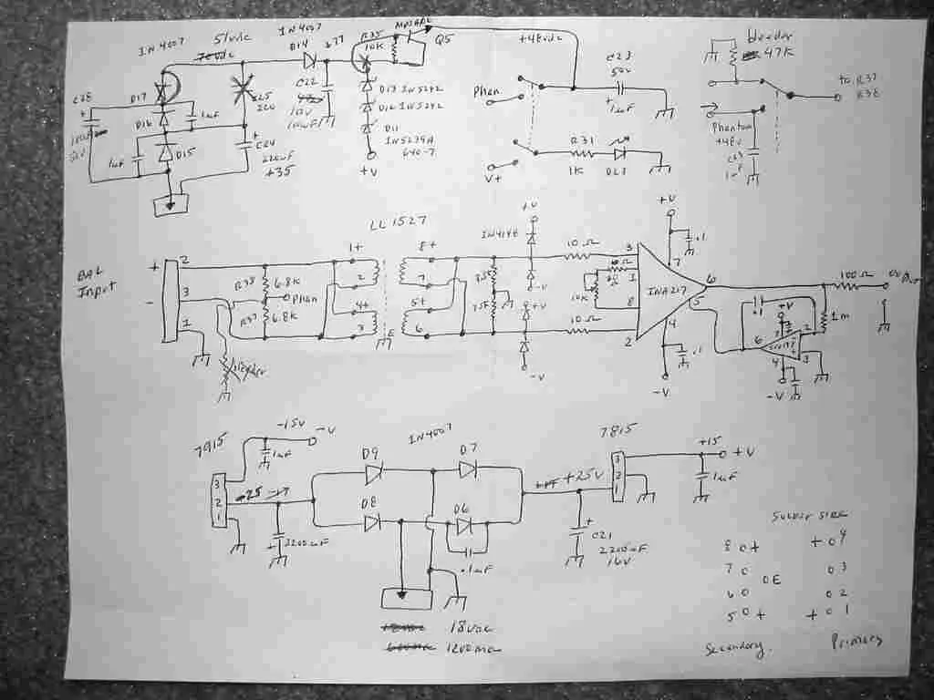

Whered you get the circuit diagrams?
Did you make the PCB yourself or order it?
Looks very nice, but c'mon, how could you leave that tube socket bare? At least wire up the heater for the glow!

I came up with the design from application notes and my own knowledge. I've attached my sketched out schematic. This design, I suspect is most likely similar to designs you would find in high end recording consoles. It is not something typically found as a stand alone unit. Manufactures are selling very cheap stuff on the low end that does not do recording justice. They are boxes that are designed to sell at "price point". You just can't make a "proper" preamp with CHEAP parts. You can make a respectable preamp for a low cost with high quality parts.
I was shocked at Mackie. I opened up my VLZ 1202 and found it loaded with cheap caps and op amps. It's no wonder why it records so funky when used as a recording console. They bragged about how it's "recording ready" but I say bull. It is a solidly built box with many features that make it handy and more useful for live than recording. Their advertising gives you the impression they are this entrepenuerul company with innovative designs but they do what many others are doing parts wise. A quality build is great but it has to be followed up with a sound equal to it's build and it just can't deliver the sound using JRC op amps and el cheapo electrolytics. Shame on Mackie. XDR op amps mean nothing, they are only a marketing ploy.
I've come to be very weary of claims. We have so many higher quality parts available today, more so than ever before, and yet the manufacutures are still using the same cheap stuff they have used for years. There is an additional cost to use better parts, but not so much so the price gets blown out of the water. The cost increase is reasonable for much improved performance. Great audio does not have to be mega buck expensive to sound good.
The PC board came out of a MP105 I had. I removed all the existing parts and used the bare board.
