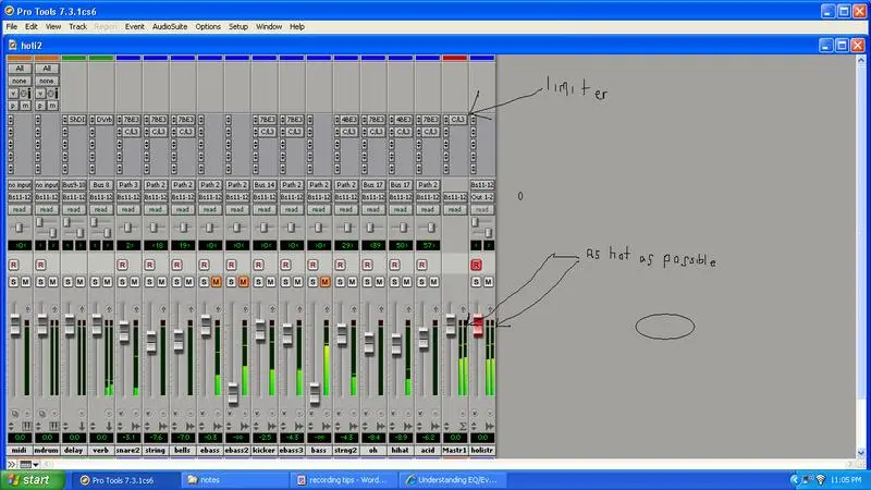

I just exported this stereo track and I brought all the faders down so I could get it all to sound good with the snare and kick; but the snare and kick are too quiet, yet they are the ones that are causing my master fader to clip.
I'm having to turn my headphones knob up to about 80% of it's capacity, to hear it well. the song is just sounding worse and worse.
I'm trying to master it in protools, which all I know about that is to put a compressor on the master fader and turn it into a limiter with a 10:1 ratio. But, before, I had my headphone level at 50% and I could boost the volume a bunch with the limiter, now I can't put 2db of make up gain on it without clipping.
I printed my screen here which caught my faders at a quieter moment but everything is about half way (average) except for the master and the stereo track I'm recording, which I try to keep as close to 0 as possible. the master in the picture appears to be about half way up the meter which is where the average level of the other faders is. the peaks on the master goes all the way up to close to 0
what in the H is going wrong?

I thought I could bring everything way down and at the end just limit it and put a bunch of make up gain on it and it would be the same volume as before.
am I just doing it wrong?
very frustrating:mad::(:(:mad::confused:

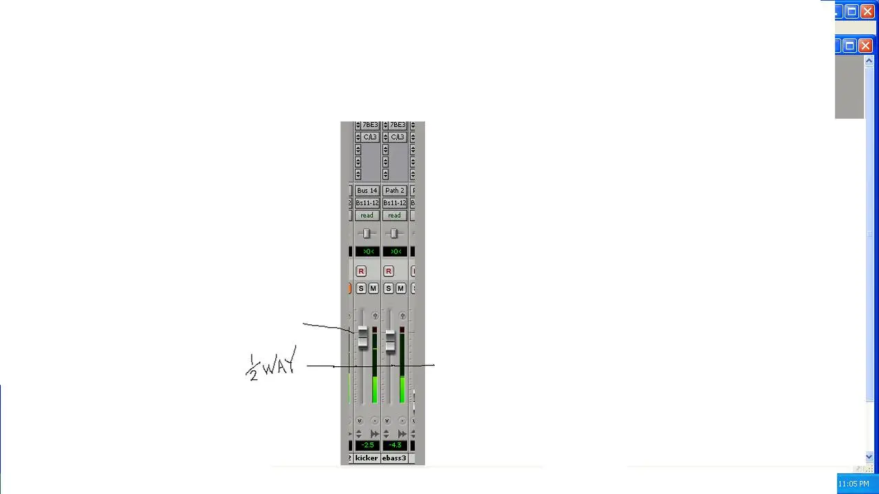

just so I have this clear:
all my tracks average levels are here at half way, including kick and snare?

Are you mixing them so all the channels read half way up? The half way up thing is for when you are recording. Mixing, you set the level of each instrument to where it sounds good.
Recording, mixing and mastering are three different processes that have different techniques and focuses. You can't do them all at once.
Record everything so the meters read about halfway up the scale. With drums there is a very short decay, so you can't really get the rms level up to -18dbfs without clipping. With drums, just have them peak around -6dbfs.
When mixing, adjust the faders to get the levels of each instrument to blend with the others as you want them to. There is no specific level that any instrument needs to be. Just mix until it sounds good. Them mixdown to a stereo file.
When mastering, take that stereo file and import it into a new session of PT or bring it up in Wavelab or Soundforge or other mastering editor. Then apply the mastering EQ, compression, limiting, etc...
Simply setting a compressors ratio to 10 to 1 does not make it a suitable mastering limiter. Mastering limiters need to be extremely fast, which most compressors are not. I'm sure PT comes with a dedicated limiter for this sort of thing. If not, I'm sure there are freeware plugins that can be used.

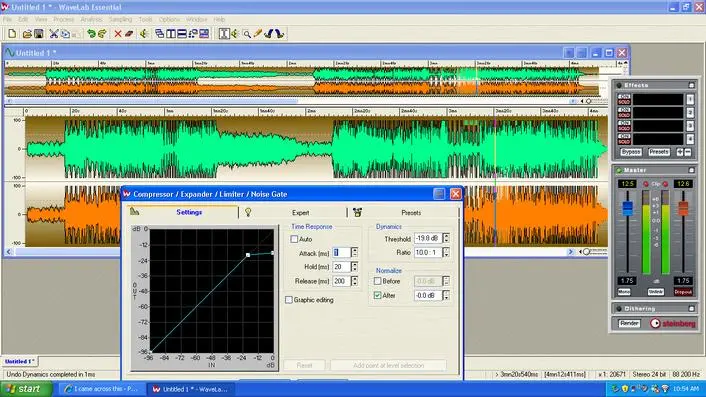

I have wavelab essential and it has a compressor/expander/limiter/noise gate all in one and it looks like I can limit it and then add gain or normalize it. I read that I shouldn't normalize, so should I use gain and I should use that after limiting right?
looks like I have some research to do on limiting.
in this picture I just added 10 db of gain. When I try to limit afterwards, it makes my very first notes peak, larger and then it frightens the listener.
does anything look wrong with this picture?
I have the limiter set up there where I tried to process it, I just pressed UNDO because it sucked.
Normalizing isn't bad, it just has it's purpose. The 'don't normalize' advice is directed at people who normalize all thier individual tracks before they mix. In the context of mastering, when used as the final step, normalizing is just fine.
