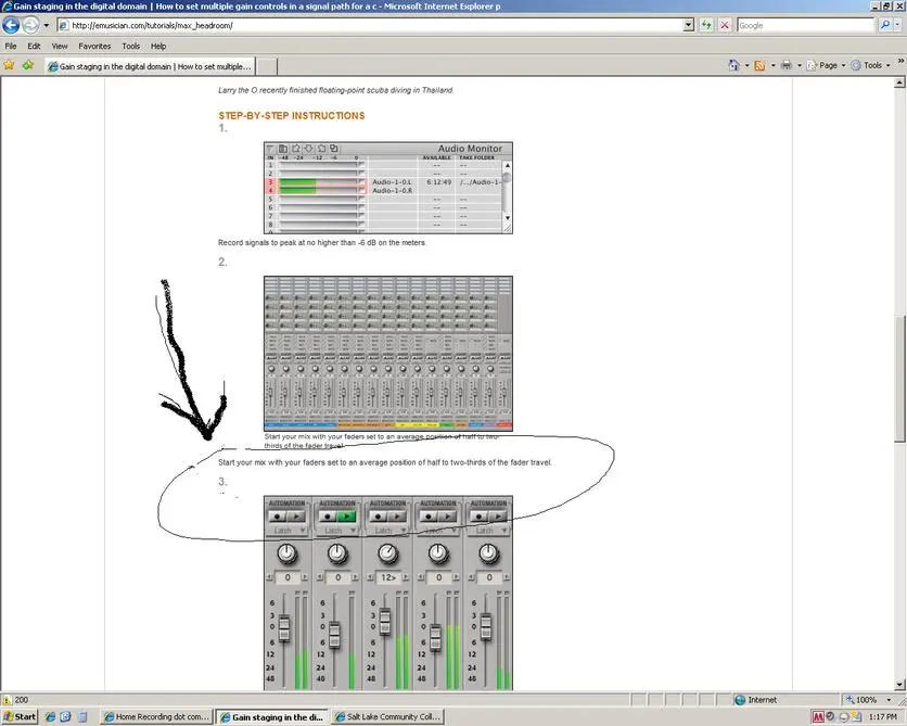

I came across this
  • Thread starter Thread starter stupidfatnugly
S
stupidfatnugly
as I was researching gain staging
"Start your mix with your faders set to an average position of half to two-thirds of the fader travel."
does this mean press record after you have pulled it down a little, or record your track and then pull it down?

this picture is of a digital mixer: http://emusician.com/tutorials/max_headroom/
That tutorial was written with "record your tracks as hot as possible" in mind. That's why you would need to pull the faders down.
If you record at proper levels, there is no need to pull the faders down.
It all goes back to the gain staging thing in the other thread, if you record at an average of -18dbfs, everything just works out the way it is supposed to and you don't have to go through all these extra steps to make up for recording too hot.
You will notice that 2/3 of the fader travel is unity gain (0) in the picture
